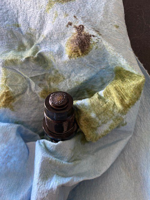

If I was having issues with metal I would be seeing shiny things at the end right? The plug was black That shouldn’t be an issue would it?
ill try to upload a picture of the plug later today

Thats the plan just trying to save up for it. Had a rough last year so trying to get back on my feet. Just trying to keep it running in the meantime. Heres a picture of the plug.
That looks like a little more than I would expect to see.  If the car was in my shop, I would drop the sump cover and have a good look; if you find a lot more of the same thing, the engine is definitely beyond the point of even thinking about an IMS retrofit.  That kind of grit running around in the oil will kill a replacement IMS bearing that is open to allow oil into it.

Cars been sitting for about a year and I haven't done an oil change for a while on it as it wasn't really driven. So I figured that was the case?

That has nothing to do with the amount of metal filings on the plug, accumulated metal (particularly ferrous metal) is a bad sign.
So that’s metal on that? I cleaned it and didn’t see anything shiny on the white paper towel?

Fine iron filings typically look black in oil.  If you still have any, try magnet on it.
Ok so I ended up taking the oil in for recycling but I did have the paper towel from yesterday and put a magnetic to it and sure it enough its magnetic. So now my question is Im assuming its the IMS bearing am I correct?
JFP saw these cars every day as a shop owner so I would never question experience......but is that really very much accumulation?  It doesn't seem that bad to me from the picture.  If that were my car I would do an oil analysis though.  Second I would take a picture, like you did, each oil change and monitor it over time.  If you notice an uptick from one oil change to the next that would be cause for alarm.

Yes, and no telling what else is screwed up.  Sorry that you’re in this predicament.  No good answers.

This was the first time you put in the magnetic plug, is that right? First time is probably the worst time.  Not sure about the one you are using but some of them like the LN product are very strong magnets.  I agree with JFP maybe it's a little more than you would like to see but not grossly so IMHO.  An oil analysis from SpeeDiagnostix is probably a good investment of $60.

Ferrous debris can come from multiple sources such as the crankshaft, valve springs, cams, and of course the IMS bearing.  Problem is that having ferrous debris running around in the oil is much like having sand in there, it will abrade all the bearing surfaces.
The correct move at this juncture is to drop the sump cover; if there is even more inside there, your options are limited, as is the life expectancy of the engine.  You cannot simple try to flush this stuff out, there are far too many places it can collect inside the engine, and it will start to move around over time, slowly tearing things up.  The oil passages in these engines are infamous for being difficult to clean out, even once the engine is disassembled, requiring the use of an ultra sonic engine block bath system to shake it loose.
A long time ago, LN set a protocol for inspection prior to doing an IMS retrofit in order to prevent people from throwing good money at a bad situation that is most likely to kill a brand new and expensive IMS bearing; that protocol starts with looking for the presence of metal in the oil, and particularly in the sump before starting the retrofit.  What you saw on the drain plug would be enough to require pulling the sump cover for inspection.  More metal there would disqualify the engine for an update.

There will always be some ferrous material on a magnetic drain plug, or inside the filter housing when using a Filter Mag; the question is how much is too much.  It is not uncommon for people to panic the first time they change oil after installing a magnetic plug, or in particular the Filter Mag, as the first change will show what has been collecting for the entire life span of the engine before the magnetic field was introduced.  Because the drain plug see way less of the volume of oil that the Filter Mag does, large amounts there are very concerning, which is why I would drop the sump cover next to see what we are dealing with.  Pulling the sump cover is not difficult or expensive, but it will answer the question about what to do next with certainty.

The sump cover is a flat plate with an attached baffle system used to reduce oil slosh.  What you would be looking for is an accumulation of material similar to what was on the drain plug, or any other accumulated material that should not be in there.  When you get it down, take pictures to post here so we can see what you find..  The sump cover is sealed to the engine with a sealant material, there is no gasket.  Reinstallation requires thoroughly cleaning the mating surfaces, applying a thin bead of sealant to the cover, pushing it into place and properly torqueing the bolts.  You cannot see the IMS bearing from below as it sits below the crankshaft, which is housed in its own carrier assembly.

Use the Loctite 5900 sparingly; excess sealant is usually found clogging the oil pickup.  Cover bolts torqued to 7.5 ft. lbs. ( I would use an inch pound wrench  set to 90 inch pounds, which is much more accurate at low torque values).
