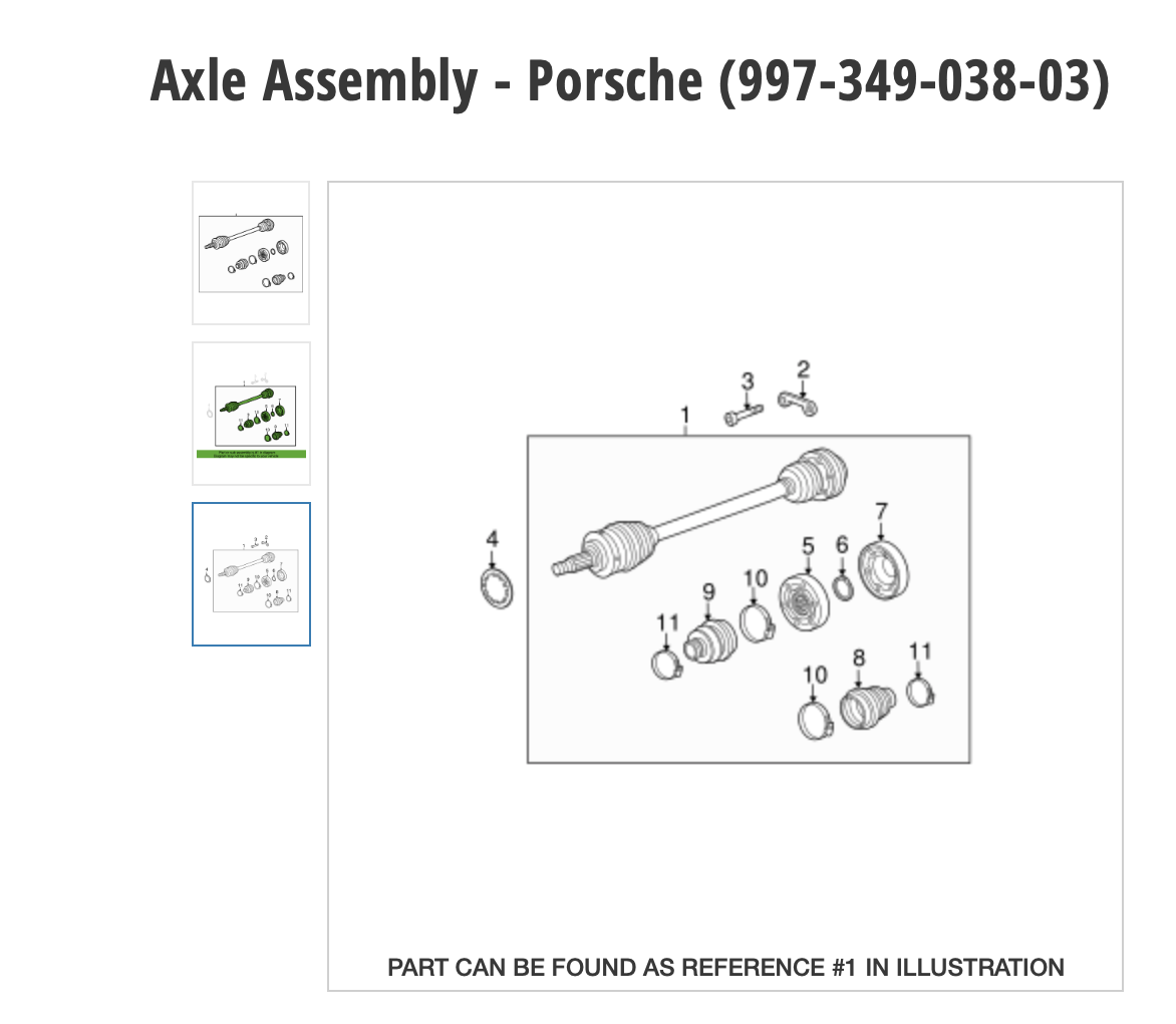

can anyone help me understand where the leaking grease may be coming from?  Could there be more than 1 source?  still trying to figure out how this all goes together, but its like shooting in the dark....  Does the rubber boot keep the grease contained?  Why does the whole part need to be changed out - according to dealer. This is the part they quoted me:
579077589_ScreenShot2021-06-17at3_54_00PM.thumb.png.e9458089b814f6ef8afae43aa5f0abb2.png
So if the rubber is just split, why can’t the boot just be replaced and not the whole part??  And now I’m wondering why the service manager told me
its ok to drive not knowing how much grease has been lost?  Should I worry about driving it with the grease being lost?
Whoever told you the entire axle has to be replaced is simply taking the easy way out and trying to replace the entire axle assembly.  The boots are available as parts as shown in your diagram.  So unless the axle is damaged, or the CV joints are bad, they are taking the easy way out, right through your wallet..................

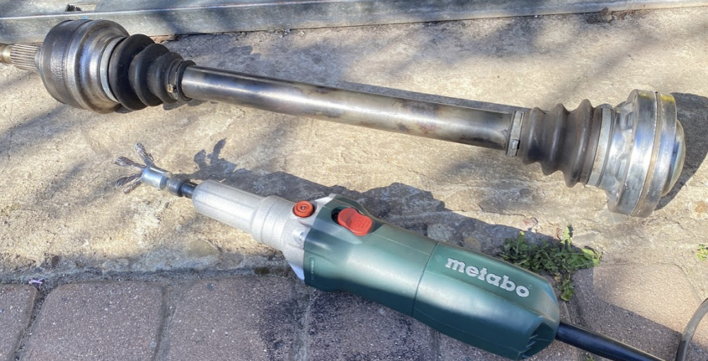

This is a photo of the unit after spending an hour wire brushing it.  I don't have pictures of the boot swap but it looks alot faster with the rust gone, fresh paint.

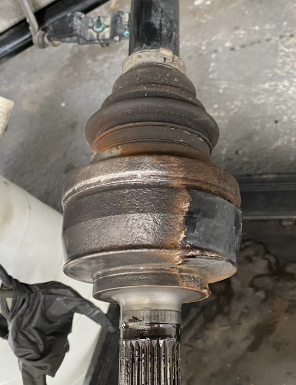

Rust removal attempt on-car.  FAil.

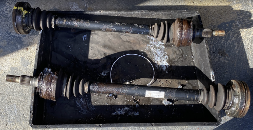

Remove both side.  Appled paint remover...  no impact since they used some paint which resists chemical.
OCD Clean
Once cleaned, I removed the boot/replaced it.  Just get the proper (Out) circlip/clamp plier or the clip will fly.
