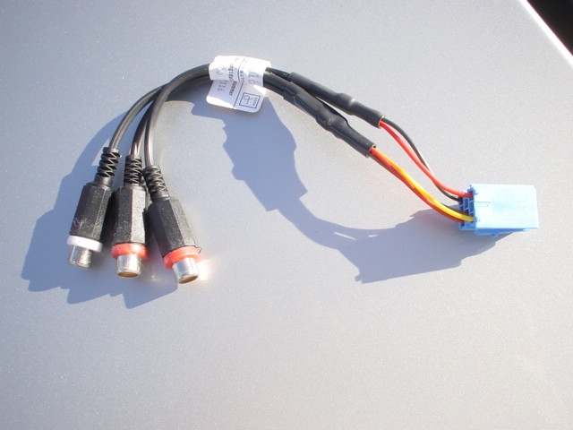

Does anyone know how to connect into the back of the stock radio? <_<
I see the diagram with the C2 & C3 sockets for the CD changer, but it doesn't break down the individual slots. I'd like to wire a relay input from an RCA Jack.
Thanks
Not the stereo guy but that is why I thought there was the aux-in adapter from Becker for the 220 radio.
Tool Pants,
That looks like it should be it!!
Does the dealer carry this?
Pardon my ignorance, but why does is have 3 RCAs?
Becker North America
Phone mute/Aux audio-in/Tel audio-in/Radio Removal keys in one kit is, BNA-116.276 ($16.40)
To order call (888) 423-3537 x1209

Actually, it turns out that the part number is, BNA-13.19. Tell them you want to hook up an iPod and they'll know what part you want.
On the back top row of connectors on the CDR-220, there are 3 connectors, unplug them all, and then plug back in just the blue Becker connector in the 1st position. The other 2 are for the CD.
(if you don't get any sound out of your radio after this, then plug in the 3rd connector, on some cars that is for the outboard amplifier.
After that, you must then enable the Aux-in feature of the radio. To do that, consult your owners manual (or the instructions that come with the Becker cable).

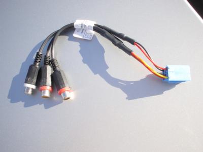

Shoot, sounds like I missed out on getting rid of my 116.276, since it won't work on my CDR23. :) Your 13.19 is likely the AUX without the phone audio, which is what the 3rd RCA jack is for in Tool Pants' pic. Do you have a pic of your part?
