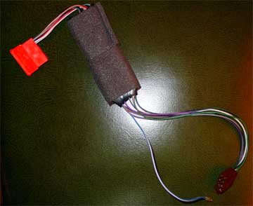

I have been talking to my audio retailer (sold me the unit but live 100s of mile away!) about this. My amp isn't powering up although everything else is. To remedy I have to get an ISO adapter for a standard head unit with active speakers. I have this already (pic) but it involves soldering the fly lead onto the lead marked "control output for automatic antenna" labelled 5 in socket A. This will provide a 12 volt supply to the amp. I feel quite nervous about this-will be an irreversible step.

It works!! :clapping: The wires need swapping as you say with 2 inputs to slot A. This socket is for the windscreen aerial as well as a 12volt supply for the amp. My audio dealer tried it on his car last night and it powered everything up! To help others, the wire C6 is black and red-the wire A5 is white.
Rather than cut wires I thought I would try and connect my ISO adapter to A5 after stripping the white jacket back a little. It should avoid cutting C6 and thus making it easier to put the stock cd player back in when I sell my car.
