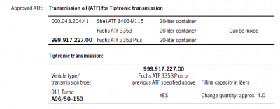

According to ZF their ZF Lifeguard 5, which is what I used, is approved for 5hp19 transmissions including the Porsche tip.
4HP20,
5HP19, 5HP19FL (1), 5HP19FLA (2),
5HP19HL (1), 5HP19HLA (2),
5HP24, 5HP24A (2)
According to spare part number of vehicle manufacturer:
ZF Lifeguardfluid5 (ZF No. S671 090 170)
=> Audi / VW Oil No. G 052162 A1 / A2 / A6
=> BMW Oil No. 8322 9407807
=> Citroen Oil No. Z 000169756
=> Jaguar Oil No. JLM 20238
=> Mercedes Benz Oil No. A 0019892203
=> Peugeot Oil No. Z 000169756
=> Porsche Oil No. 999.917.547.00
