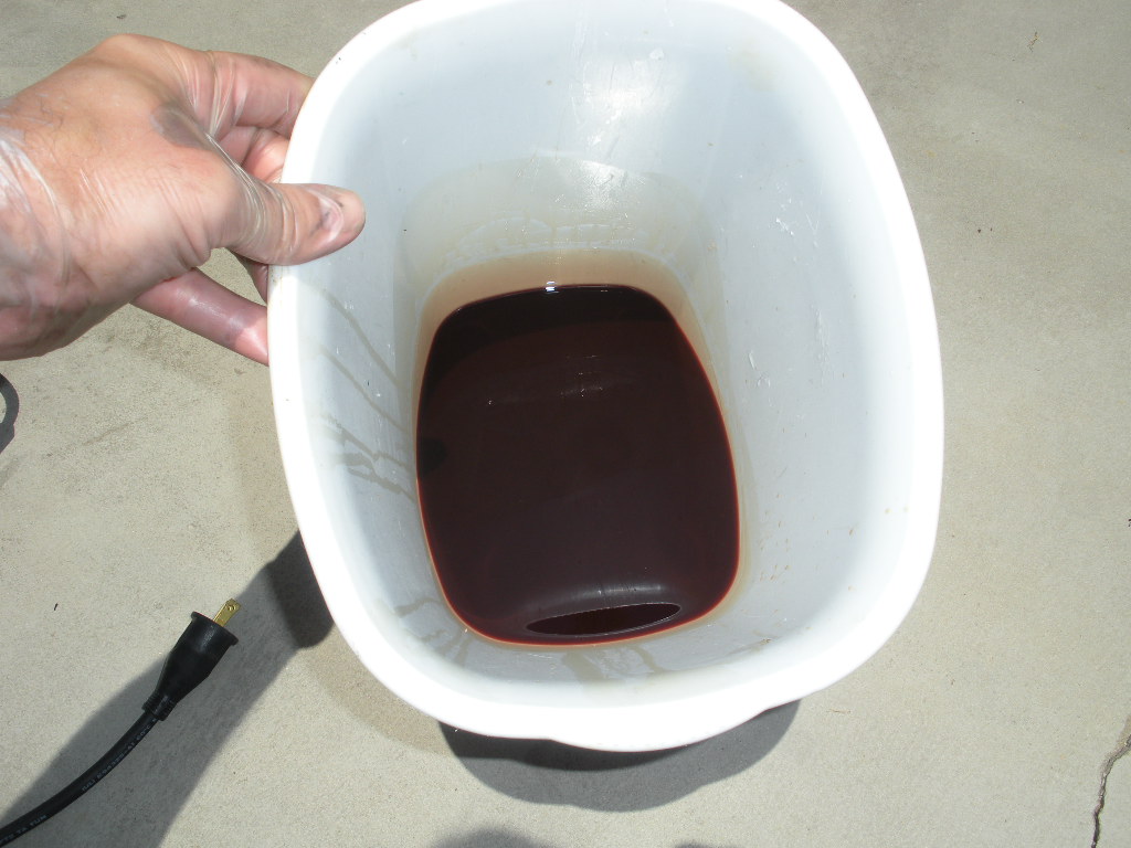

Changed my fluid on my 996 MY03 C2. Everyone told me not to... "you only have 13,600 miles!". What came out of the transmission was barely red and full of brown suspended matter (old, burnt, and decayed ATF fluid). The new fluid is pink/red and completely transparent... I am glad I did not wait... Obviously, the fluid goes bad from sitting over the years. BTW, I purchased the "Porsche charging hose" for MY02 and newer 996. This is the best way to refill the tranny. $40 from Sunset Imports! I placed the charging hose on the bug sprayer setup and presto....easy to refill your tranny! I used Porsche approved Fuchs ATF 3353 plus (Titan) I found at Pelican Parts. AND, it is very important to note that the overflow plug needs to be put back BEFORE you turn off the engine...or glup...glup...glup... you will waste a liter of fluid! :opost-44743-1250728494_thumb.jpg
Your fluid looks like you frequently track the car ? Anyway, my first service on my 996 was today at 33K on the odo. The fluid, pan and magnet was quite clean. I went w/the Porsche OEM fluid p/n# 999 917 547 50 (just under 6 quarts w/filter). The fluid retails out at a whopping $26.53 EACH but what the hell, it's worth it considering what things looked like.
