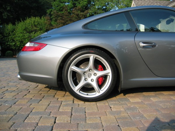

I just had the -20mm Sport Chassis installed today at Suncoast Porsche for my 2006 997, wow, what a difference. I'm told I'm one of the first ones in North America to have it. They've assembled a kit with the springs, shocks, rear mounts, anti-sway bars, and other associated hardware. My bars didn't come in yet, they're being delivered from Germany.
The ride is firmer but not in the least bit objectionable. It transitions better and the car doesn't shift around while you are driving quickly. You do notice bumps, cracks in the pavement, and paint lines more with the suspension but it doesn't feel as stiff as a 996 GT3.

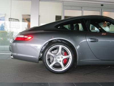

When you park it next to a 997 with standard suspension or a 997S with PASM they look like SUVs in comparison, especially in the rear with all that air above the tires. The -20mm lowers the car down to where it should be. We measured with a tape measure and it dropped the car down 1/2" in the front and 3/4" in the rear.
If you have a steep driveway this suspension isn't for you. I used to drive off the side apron of Suncoast Porshce with no problem but now the under-fender lip spoiler thing scrapes. I'm crossing my fingers tomorrow that I can still get it on the trailer fine for towing.

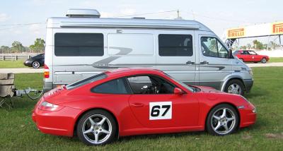

I'm driving it at Sebring this weekend both Saturday and Sunday. I'll let you know my impressions after I get back.
Tom :D
Wow the car drives great on a track. I spent the whole weekend at Sebring and passed our region's instructor's school. I'm getting nationally certified as well. The -20mm is the way to go if you want to emphasize handling and you're willing to give up some ride compliance over bumps. The other thing is you're going to scrape the under-nose spoiler lip thing.
was under the impression '-20mm sports suspension' drops both front & back 20mm?

It's $1749. They used my car for that photo and after driving it at Sebring two track days and two autocrosses the car sits a little bit lower. They took the photo the same day it was installed and aligned.

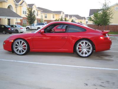

I have 2006 C2S
guards red, blk leather red seatbelts, PSE, rear spoiler techart, 20in rims, HR springs, RUF shifter and paddles. the look with the springs is killer, i cant look at a stock porsche anymore and not thnk that the gap is huge. i agree with the post above about the handling, my near term pregnant wife almost had a cardiac arrest when i took her in it with the sport turned on. the exhaust is def worth the money.
this car is amazing, the only problem is u run out of road very quickly.
hope everyone loves theirs as much as i do. steve
