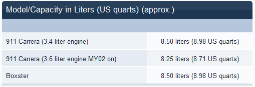

Loren, when I change my oil I always put 10 quarts. I was told by a Porsche tech that they always put 10. But after reading some posts here some people have been only puting 9 quarts. How many is the correct?
That will depend on your model and model year.
See the table at the end of the DIY.

Also saw posts mentioning it takes approx 8 liters and others up to 9.5 liters. Is this because of the oil cooler? is it better to drain that also?
