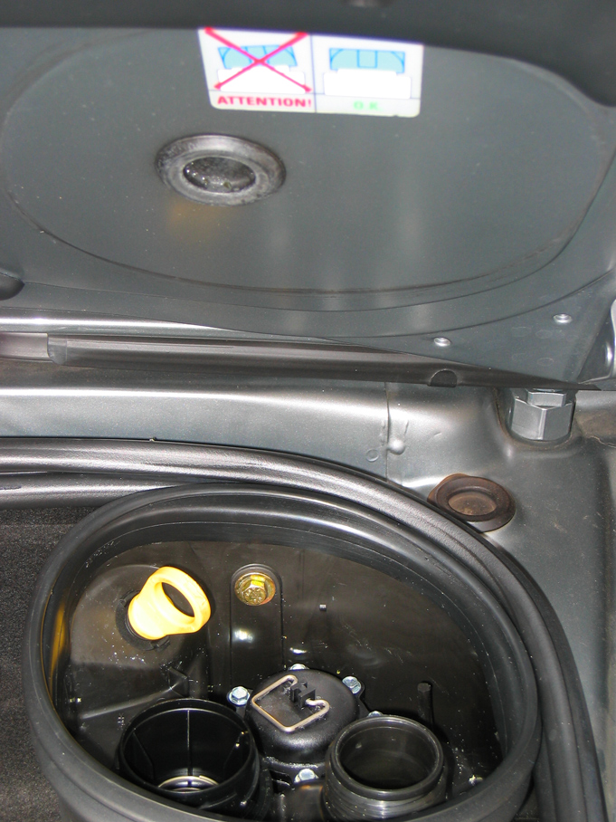

I recently noticed the area inside the rear trunk on my 2001 Boxster above the radiator cap is slightly moist, with a light, slick film. I already had the new style radiator cap, which was installed about a year ago when the coolant overflow reservoir was replaced. Just to be on the safe side, I replaced the radiator cap, but still have some slight moisture after driving.
I popped the cover off the oil and radiator fill caps, and even though it wasn't spotless, it was dry
The moist area is in the top of the following picture:
Any suggestions on what else to consider before taking the car to the dealer? If the coolant overflow tank is leaking, do I have to take the carpeting out to tell, or would it have been obvious from the view I have here?

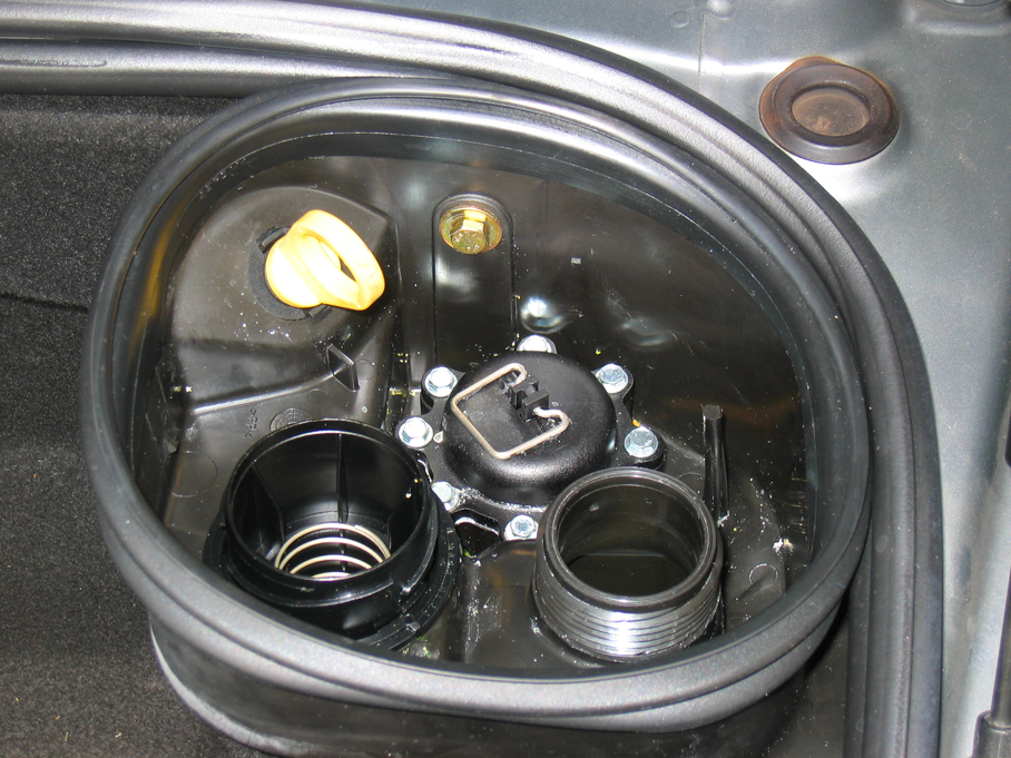

What is the contraption between the oil and coolant fill openings? Is this something I should try to tighten the bolts on?

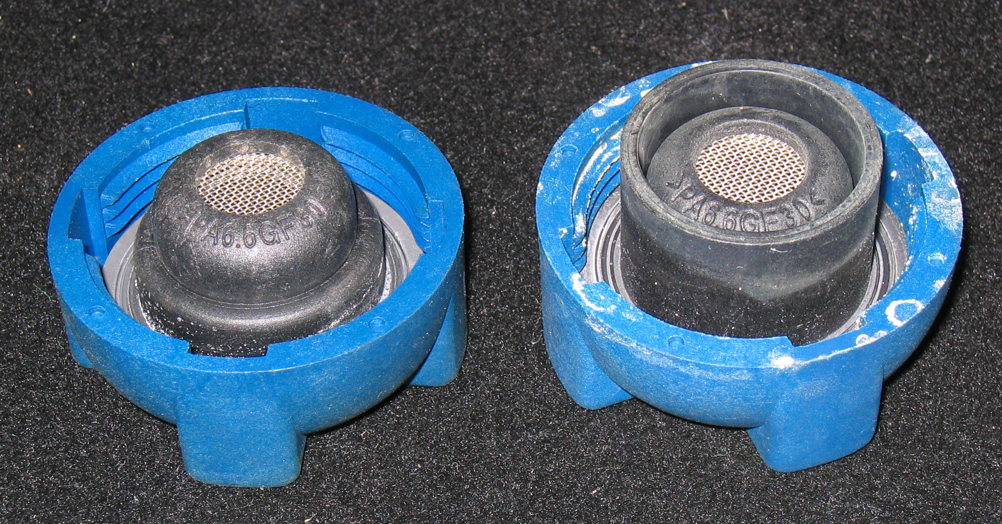

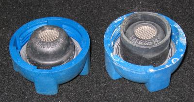

Just for information, here's the old vs. new style radiator caps:
Does anybody know if the Cayman has yet a newer style radiator cap. The two Caymans (Caymen?) I've seen at dealers have a different looking radiator cap
I think this moisture is normal for all Boxsters I have seen, including my 2001 S.
No system can be 100% air tight, but the new type cap reduces this moisture. It is just that due to the position of the reservoir it is noticeable. In the engine bay of a front engined car you would't even notice such moisture.
If the reservoir leaked the area underneath the carpet and eventuallythe carpet itself would get wet, and you would notice loss of coolant.

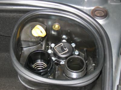

The contraption is the bleed valve. You might check the bolts for snugness, but I would not advise tightening them unless one is obviously loose. If you ever need to bleed the system, pop the wire up so that it is vertical. This allows air to bleed from the system without needing the pressurised equipment the dealer uses.

Yes, coolant cap (01 suffix) replaced at the same time as the tank about a year ago. When I started noticing moisture, I bought another coolant cap from Sunset (also 01 suffix) and replaced, but still notice moisture. I cleaned everything out, and no obvious leaks. I just lightly snugged up the bolts on the bleed valve - we'll see if that makes any difference.

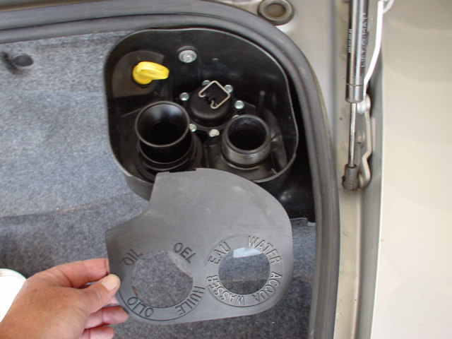

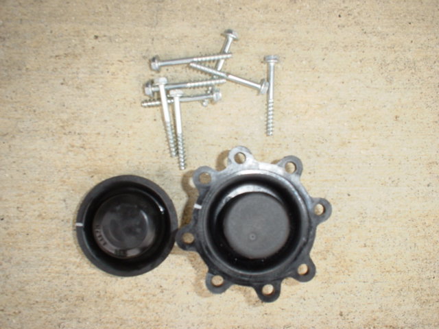

Well, I did ask one of the mechanics. The same mechanic who told me how to replace the tank, which I did last month.
He does not consider this condensation normal. He said to snug up the 8 screws on top of the bleeder valve and see if that makes a difference.
If the picture looks strange it is because it is my old tank sitting on the driveway. I removed the 8 screws to see what was under the bleeder valve cover.

Just a note.
My January 1997 original tank did not have o-rings for the bleeder. Instead, it had a rubber diaphragm, thus this picture.
Looks like a bleed valve change hapened for model year 1998.
Since my replacement tank is a .07 then I should now have the bleed valve with the o-rings.
