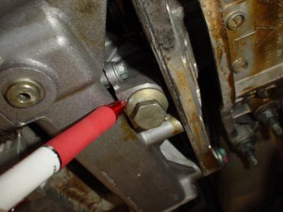

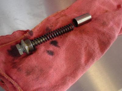

I obtained a copy of the TSBs dated Feb. 27, 2006, for the 2.7/3.2 987, and the Cayman (987). The TSBs are identical. Since I am in the US I have what was issued by Porsche Cars North America, Inc.
Porsche calls it a " Screeching Noise From The Engine During Warm-up" at about 2,000 rpm. The control piston in the oil pump cover is to be replaced with a new design, for engines made as of December 5, 2005.
The mechanics did not have this part out of the engine on a 987, so they took one out on a 986 for my sample pictures. Takes longer to get the car on the lift then it does to replace this "piston", which I would call a valve, which is at the end of the spring in my second pic.
Share this post
short of the hexhead bolt, looks similar to a buffer/recoil spring on any handgun. How odd.
