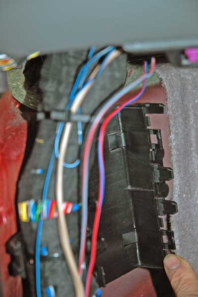

The fuse block is held in by 4 clips on each corner of the box (block). You can see 2 of the clips in this picture.

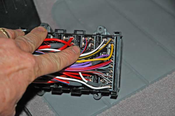

Just pop the clips free and pull the fuse block free so you can get at its backside.
Here is a picture of fuse box mount with the clips. I have already pulled off the fuse block.

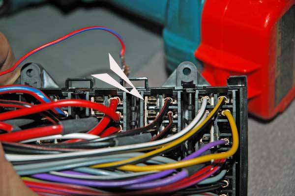

Crimp and or solder a female spade connector onto the red/blue wire that will be attached to the fuse block. Turn the fuse block over and insert it in an open spade where my finger is pointed. As you can see, I have already attached my red/blue wire there. (2nd row, outboard connector)
That is it! Now put everything back and you are done.

The fuse box has a carpet cover on it that is held on with 4 screws. Take the black cover off to expose the fuses, and you will see the 4 screws. Take them off, and pull off the carpet cover.

I have detached the fuseblock and turned it over and it is a free spot to put the wire in but it wont fit!
Here is a picture of the connector.
It is a grey plastic thing halfway down, can I move this one?
Is this the right way to connect the wire? In the Technical Info from Porsche it says that you should crimp it to the BK/RE wire for fuse B10.
In your picture it seems that the RE/BU wire is not connected to the fuse
becouse the power source is on the same side as you have connect the wire. Right or wrong?
/Magnus
You are on the right track. you just have to stick the pin connector into the little hole that there
With a little effort it will slide down into the fuze block.

The B10 bus is connected to the first 6 fuses from the end, so you can plug into any of those that has an open hole. I would suspect that the US and Swedish cars have different things taking power from B10. Just pick any of the first 6 holes that is open.
The little connector on the end of the red/blue wire should just be the metal pin, no plastic shield around it.
Of course you can also use an in-line crimp splice to connect the red/blue wire. Then you just pick any wire that is plugged into the B10 buss.
