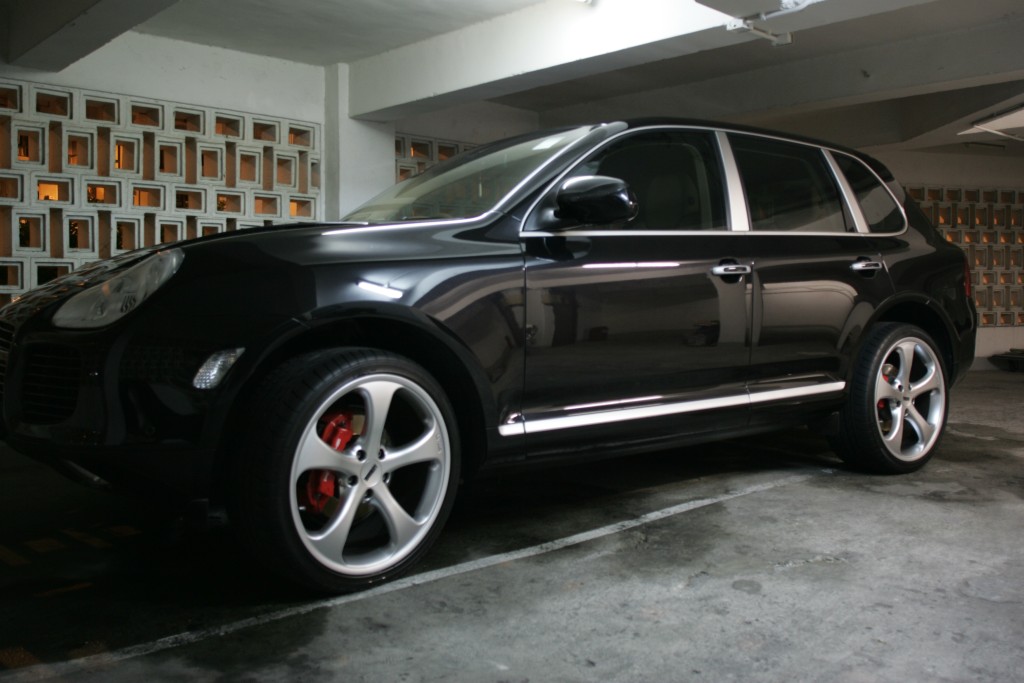

Sorry for not replying sooner. The ride on the H&R spring alone is rather bouncy and doesn't feel right at speed. Then I had a set of Bilstein shocks put on to match the shorten travel of the spring and it's all firm up but harsh on bumpy road.
I have attached a photo for my Cayenne with H&R springs & Bilstein shocks combination.
