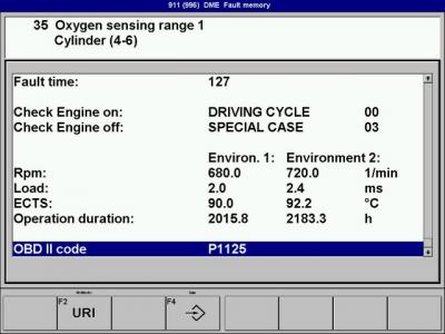

I had P1123 and P1125 for quite a while, and since I switched my MAF it hasn't re-occurred. The fault was stored in the fault memory of the DME, and it showed the number of occurrences. You could read the faults with a PST2, but they did not show up on a scan tool. Because the "fault" was intermittent (it showed as something like 10 events per month) it wouldn't fail an annual UK emissions test. I suspect that Porsche consider that such faults would show up on a service visit, and could be rectified at that time.

I am located in Greece, that means my car is in the RoW category.
Are the attachments you posted taken from PST2 ? Can I buy a scan tool to read the error codes P1123 & P1125 to do the job myself ?
The screen shots were taken from a PST2.
I used to have an EZ-Scan 5000 which didn't display the faults, but they were there when you read the fault memory with the PST2. I'm not sure whether other scan tools or code readers would show them.
I wish I could be more help, sorry. :(
