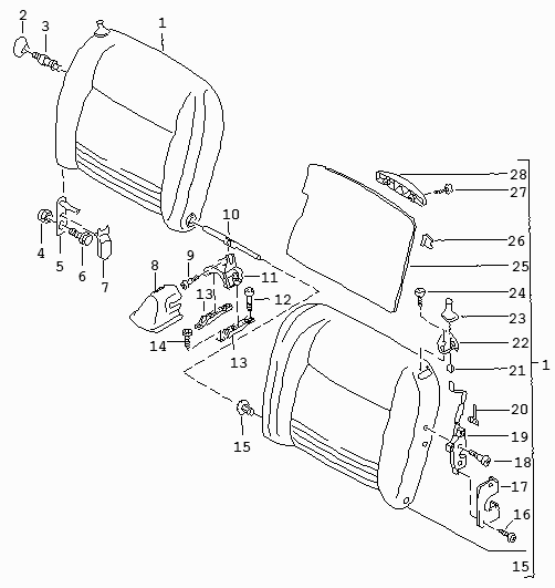

Pull the plastic covers off (items 7 (one each side) and 8) and then remove the bolts and hardware.

Hi it is really easy once you've done it. Keep that in mind as you walk through these instructions. On each side you see little black plastic bolt covers, snap them out/off, and you'll see a bolt holding an adjustable bracket for the seat back. Now remove the bolt and do the same on the other side. In between the backs you'll see a little triangular shaped plastic cover(#8 in the diagram). You'll need to raise the front lip of it away from the carpeting and at the same time pry it towards the front of the car. it is shaped a lot like a dog's head biting the bar that the seat backs are on bear that in mind when prying. If you put a screwdriver in the back of the dogs mouth and pry it off of your seat bar. You'll see the final piece of the puzzle once it is off. HTH
