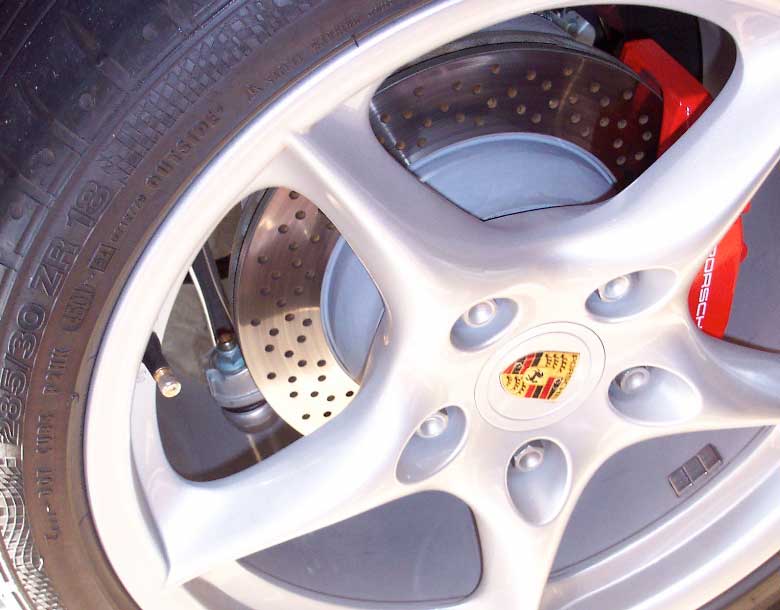

Actually, if you want to paint the rotor hats, clean them off, use some steel wool to get the surface rust off etc. then wipe them down with some paint thinner or 3M general purpose adhesive remover.
For paint, plain old grey primer is the OEM color and material of choice. For a nice trim, I also paint the rotor vents sliver.
It is best if you remove the rotor from the car to clean and paint it. That is not that hard, just take the caliper off with 2 bolts, and then the rotor is just held in place with a little phillips screw.
As far as masking the rotor or not getting paint on the surface, forget about it! Just focus on painting the hat, and don't fret about the over spray on the disc surface. The first time you apply the brakes, the pads will clean off all of the over spray for you , and leave a nice line. Of course with that said, it is best to apply the paint to the surface you want coated. But don't worry about overspray.
If you have ever bought brand new OEM discs, especially german ones, you will find that they are completely painted. With the first application of the brakes, the paint is completely removed with no harm to anything.
I have been painting my rotors on all of my cars for 30 years like this, and have never had a problem.
Here is a picture of the last respray I did last month.
here is what they look like when done.
