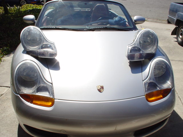

Ok guys, I got a set for a good deal ($400) from a member on rennlist.com (tentster). He was in the San Diego region so he dropped it off too (Nice chap !) Its a regular halogen set, clear with the clear triangles.
Its at the body shop right now ... will let you guys know soon ...
