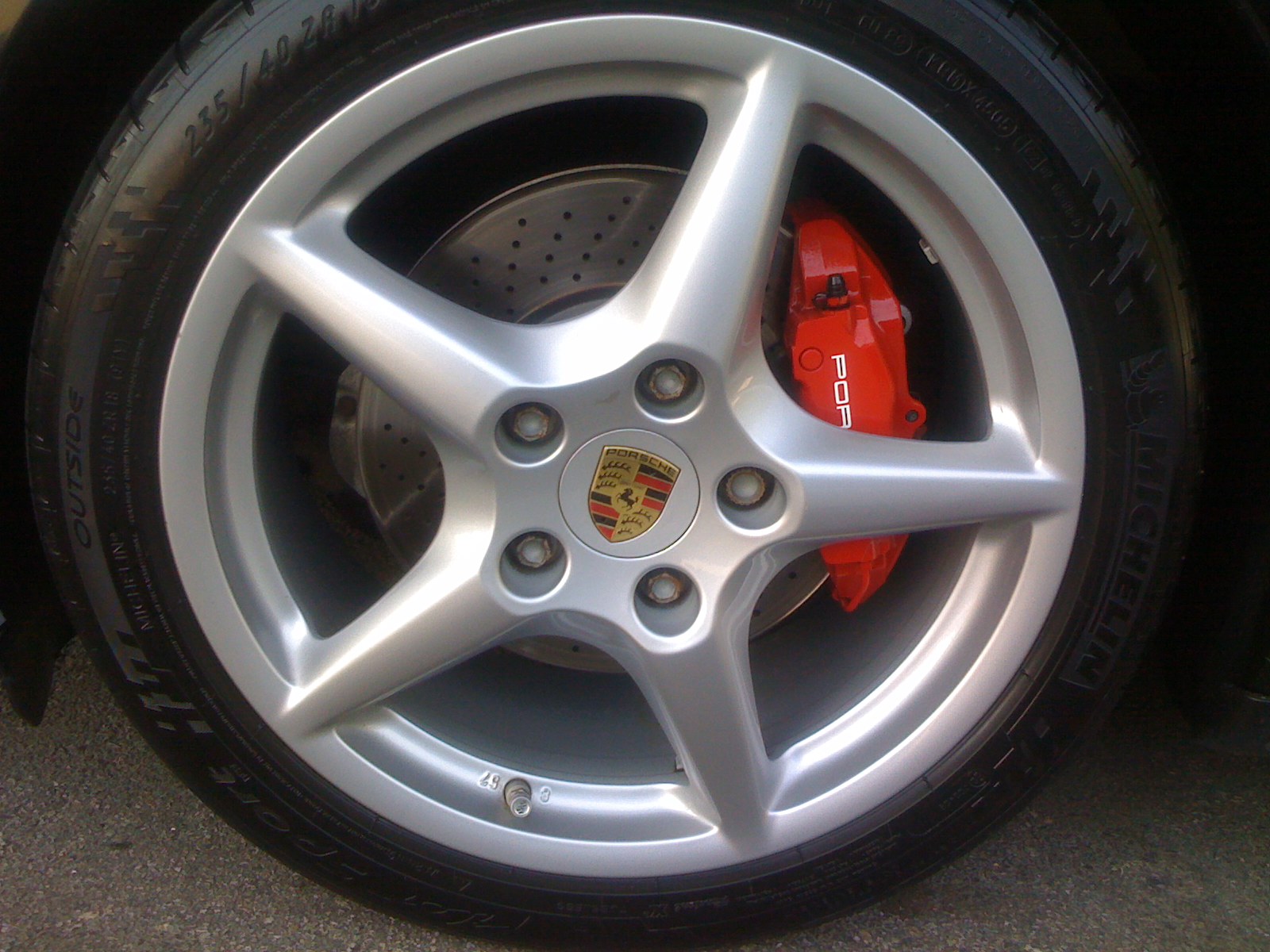

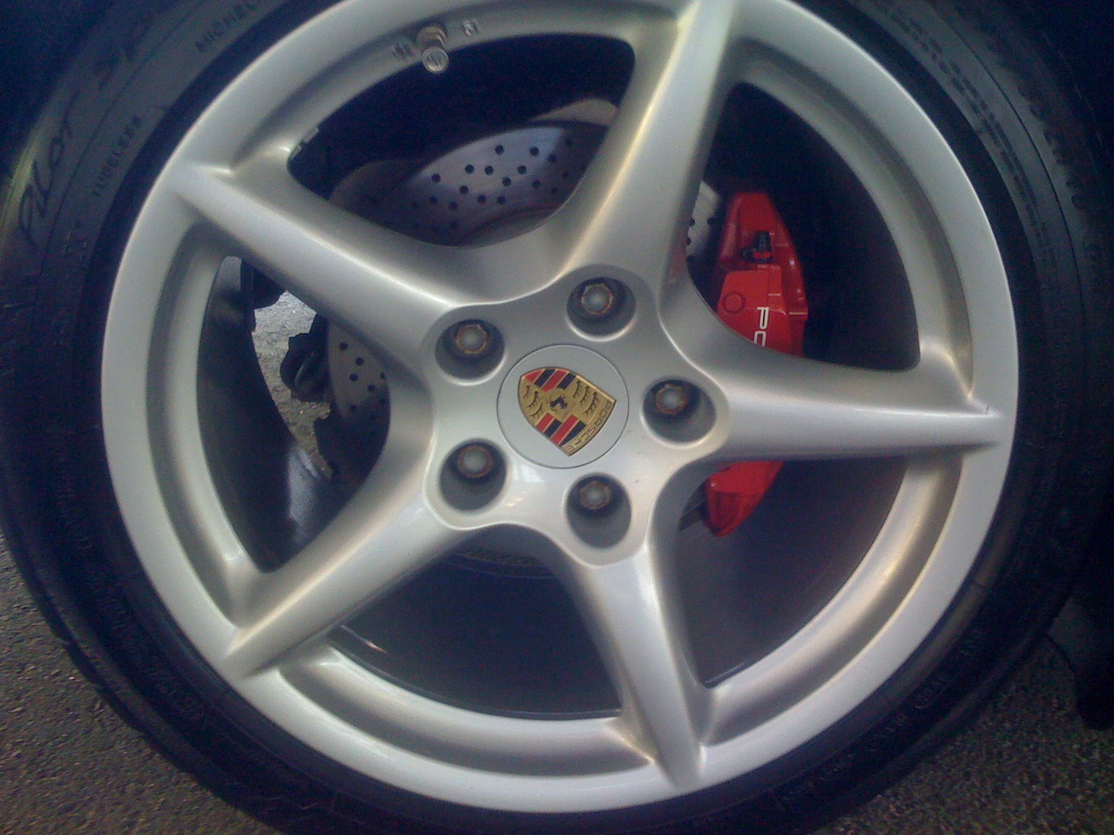

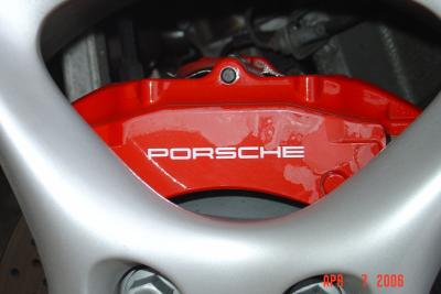

Ok, all done. Pics attached.
dcooper:
The calipers (and the rims) look really, really nice.
I'm a little confused about the orientation of the decals though. Could you label the photos (i.e., LF, LR, RF, RR) ?
I am about to paint my calipers and would like to do the decals the "correct" way.
Regards, Maurice.
dcooper:
I am about to paint my calipers and would like to dol the decals the "correct" way.
Regards, Maurice.
Sorry about that. We (the Porsche service manager and I) closely examined a 997 Turbo that was onsite and oriented the lables exactly the same way. Let me see if I can label them.
Damon

Ha..I just realized we may have gotten one of the rears the wrong way (both are facing down, when the left rear should be pointing up). Oh well. You get the idea.
