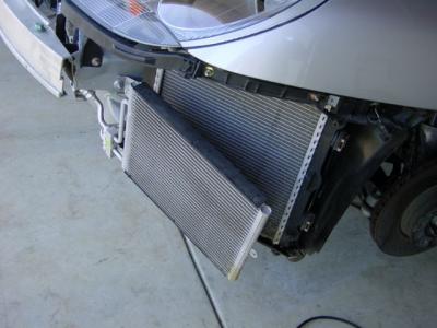

Loren - Thanks for the feedback. I've found what I thought were the 2 front radiators (on the front, outside edges behind the front bumper), but where are the AC condensors?
I don't think that is high enough to worry about.
The fans are behind the radiators. Just make sure that both the radiator and A/C condensers are clean of debris.
