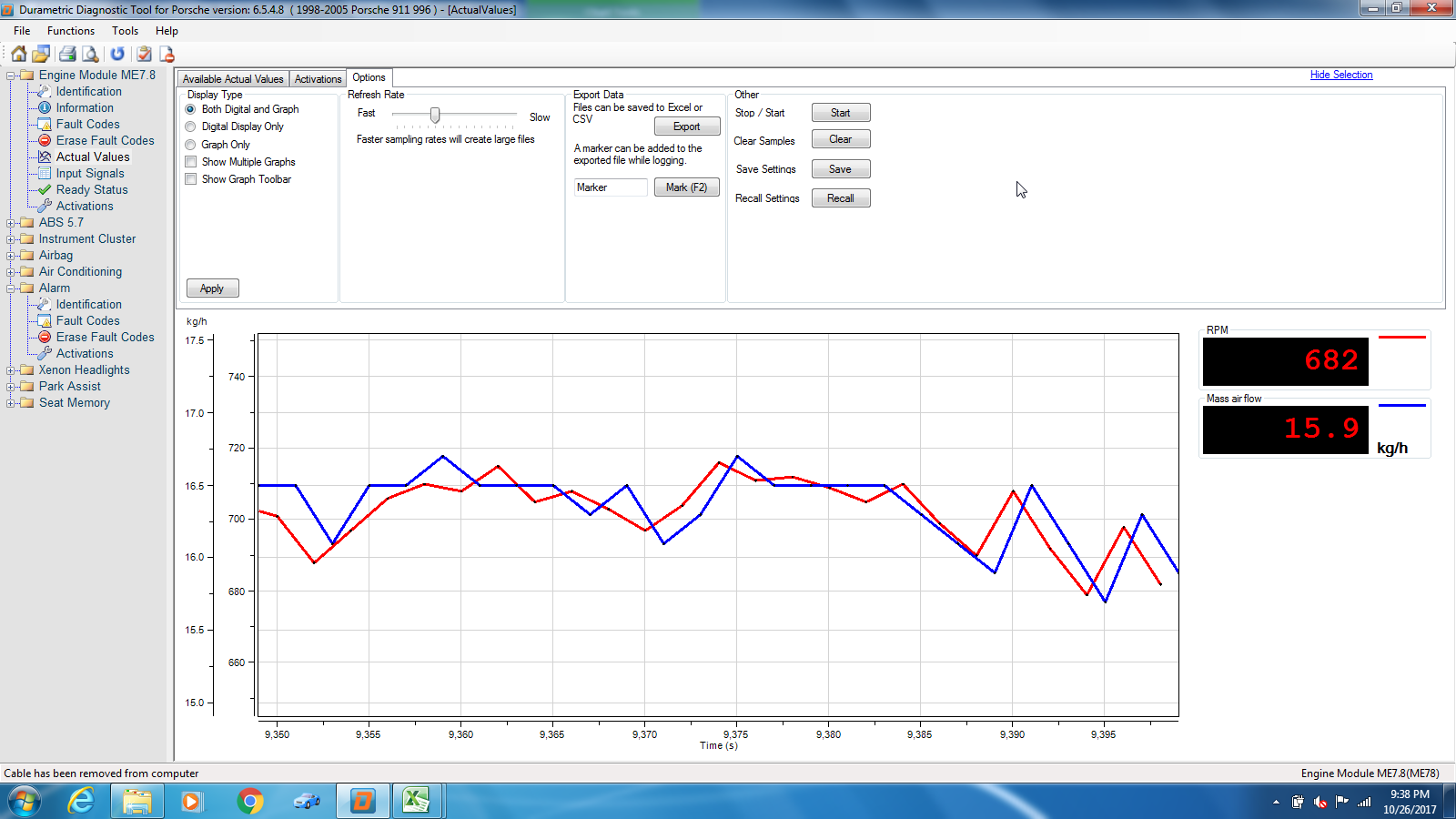

So, I finally got a Durametric so I can test the MAF. I plotted MAV and Idle speed in the image below. As you can see, the curves lay right over the top of each other, as you'd expect. What I don't know is if this variation is normal.
I cleaned the MAF with CRC's specialty cleaner. No effect. I pulled the oil cap off with engine idling, slight increase in engine RPM, no increase in the shudder feel.
Any ideas?
