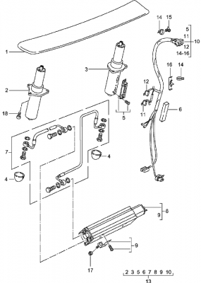

Where do these microswitches live and what is the part number
Cheers
Andy
Follow the harness - items 11 and 12.
