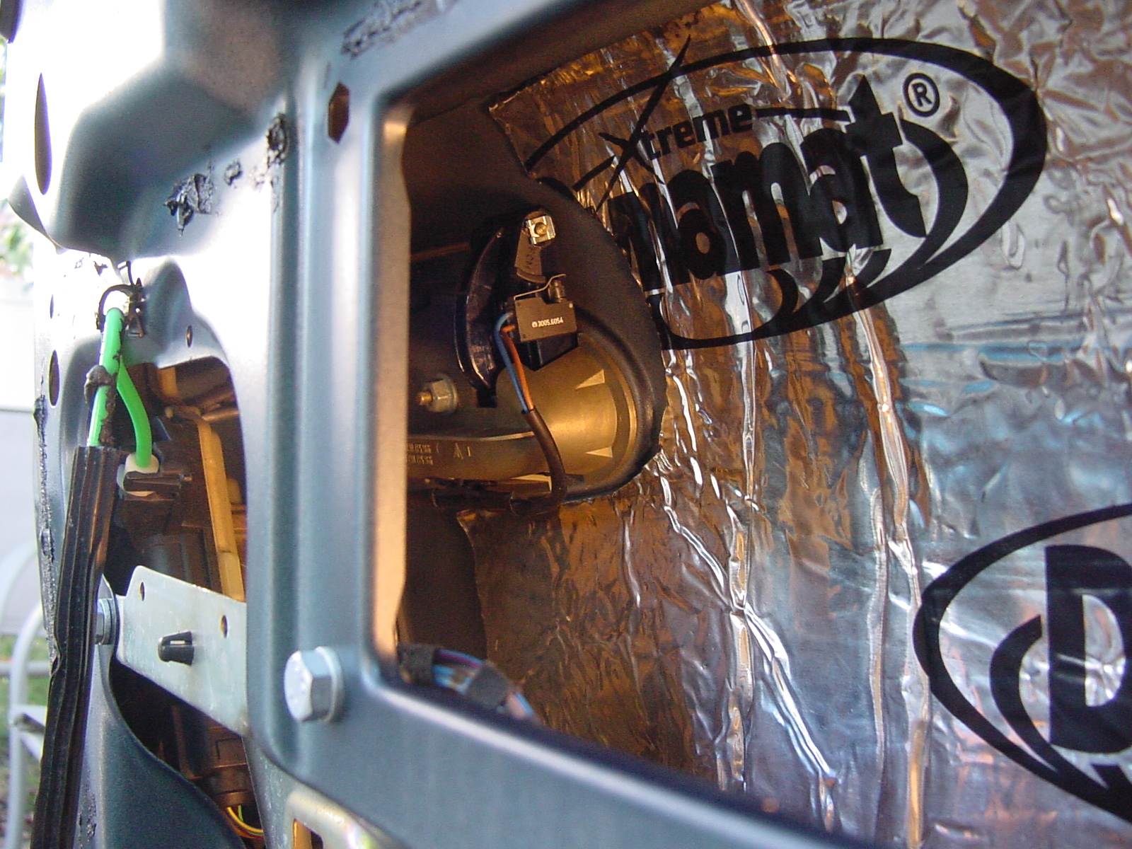

Tool Pants:
Here is a good photo of one of the (three ?) microswitches inside the door for your files:post-6627-1192161811_thumb.jpg
Thanks very much for the info and great photo.
That is certainly the elusive 3rd one!
Just to clarify...
The microswitch in the photo is the one behind the outer door handle. You can see the small black part (just above the microswitch metal lever) that acts on the microswitch. As the handle is pulled up from the outside, that small black part "rotates" and presses on the switch. That is what causes the 1/2 inch drop of the window when you initially pull on the outer door handle.
There is another similar switch (not shown in the photo) which is mounted on the backside of the door panel and which has a similar effect on the window when the inner door handle is pulled.
To locate the remaining switch, follow along the (green in my '97) plastic cable which you see sort of bent over at the left center of the photo. That cable, which is covered by a black fluted rubber cover as it goes forward to where it is connected to the inner door handle, is the cable that acts on the latch which is on the (rearmost) side of the door to unlock the door. You can see where it leads to sort of vertical (slanted) cylinder with wires coming out of the bottom. The remaining switch is in that location, and that is the one that is tripped by either closing/opening the door, or by closing the latch (2 clicks) as Tool Pants suggested above.

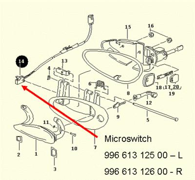

I got a picture that might help identify the switch
Ken:
Thanks for taking the time to post the fix. For future reference, which one of the microswitches was not "snapped" into place?
Maurice,
Sorry about that. I did not take any pictures of the switch or work (learning point for next time). However, this switch is the one just behind the interior door handle. As I pulled the panel off, the switch was connected right behind the door handle. In lieu of my crude explanation, I'll take some pictures and get them posted here.
Regards,
Ken
Ken:
Great work in posting the photo and the diagram.
You can rest assured that someone else will come along here with the same puzzling symptoms that you had, except that now you have helped to unravel the mystery and solved the puzzle.
I had a similar but intermittent problem some time ago.
It is VERY easy to trap the cable which connects to that microswitch between the door card and the door in proximity of the hex bolts.
If the shielding is broken and the 2 wires make contact it is the equivalent of holding the internal door lever open all the time (hence triggering the microswitch). The car thinks the door is being opened and keeps the courtesy lights on, won't allow locking/arming of alarm etc....of course the small areas of contact between the wires and general movemement in that area made the problem intermittent and even harder to trace!
