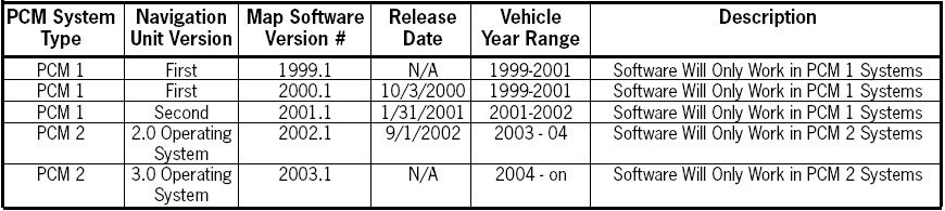

From TSB 0307 9112 PCM Software Release Versions (dated 11-24-03)
Vehicle Type: All PCM Equipped Vehicles
Model Year: As of 1998 (W)
Information: This bulletin is to inform you of the PCM software release versions. See the Technical Information Bulletin
pertaining to the specific vehicle you are working on for VIN cutoff dates.
PCM 1:
- Utilizes seven (7) map disks to cover the United States only
- Optionally installed in MY 1998 to MY 2002 vehicles
PCM 2:
- Utilizes two (2) map disks to cover the United States and Canada
- Optionally installed in MY 2003 and up vehicles.
- You can use updated map CD version 2003.1 in early PCM2s after updating the operating system from 2.0 to 3.0. See Technical Bulletin “PCM2 and BOSE Spare Parts Requirement” referenced below.
PCM System Navigation Map Software Release Vehicle Description
Navigation disks are available from NAVTECH. Their customer support number is 1 (888) 628-6277.

How I can know if my pcm1 system has 1999.1, 2000.1 or 2001.1 map version??????
