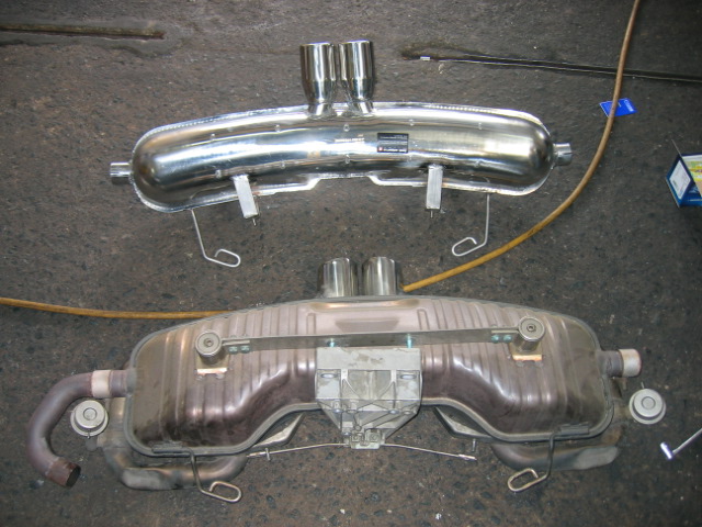

I recently posted a picture of the 02S muffler and mounting bracket, if you haven't seen it it will help visualize where to find the bolts.

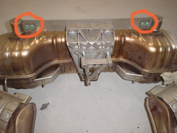

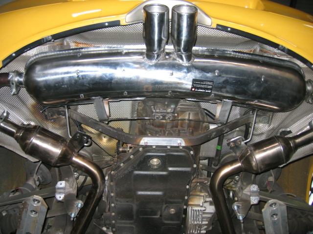

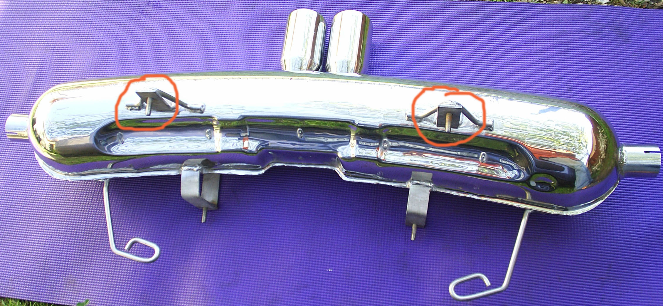

So I'm digging through these old posts and need some clarifications. I recently bought a Dansk exhaust and want to know if I need an adapter to mount to my '99 Tip Box (non-S) or not. In the first pic, to remove my stock muffler I need to undo the 4 fasteners circled in orange correct? Is it possible that there are only 2 instead of 4 fasteners? I can only seems to find 2 by feel. Do the two cylinders to the outside of the orange circles remain on the stock muffler? I can leave the triangular adapter piece along with the upper crossbar attached to the car?
In the 2nd pic, the top two bolts (circled in orange) on the Dansk muffler goes into two of the four holes on the upper crossbar (where 4 fasteners were removed in previous step) correct?
Thanks for your help.
OK so I think I found the answer to my question. I figured I'd post it in case others were confused as well. The pic of the stock exhaust above (borrowed from another thread) is from a Box-S, which has the cylinders attached to each end of the cross-bar. I have a '99 Non-S which does not have the cylinders and only 2 instead of 4 fasteners near the top of the exhaust (item #29 in 1st pic below). I've hijacked pics from yet another thread that shows the differences between non-S and S exhausts. The first pic is a non-S and the 2nd is an S model.
