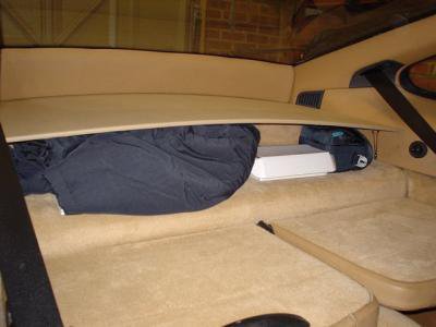

  2. Firstly, I have to confess that this was my brother's idea, and he was the first to do it on his '99 C4. We have always been frustrated with the lack of storage space, for stuff that you want to keep out of sight, like portable satnav, camera, jacket, etc. The platform is made of 6mm (1/4") MDF board. Mine is covered in a leatherette I got from eBay which isn't quite a perfect match for the savannah leather, but is extremely close to the carpet colour. My brother used black alcantara for his, as he has a black interior. We made a cardboard template to get the shape right, which is a close fit at the sides. The back edge goes under the back panel by about 12mm (1/2"), and the front edge is cut square to the back of the seats. It is a snug fit under the back panel, which holds it nicely. The MDF was cut from the template, and the covering was stretched over the MDF and stapled on the underside. We screwed some small metal tube clips to the MDF on each side, and cable-tied them to some modified clips which just hook under the side panels. There isn't anything else holding it in place, so it can easily be removed if you need to gain access to the DME under the rear carpet. Hopefully the pictures will explain all. Hope you like it!
