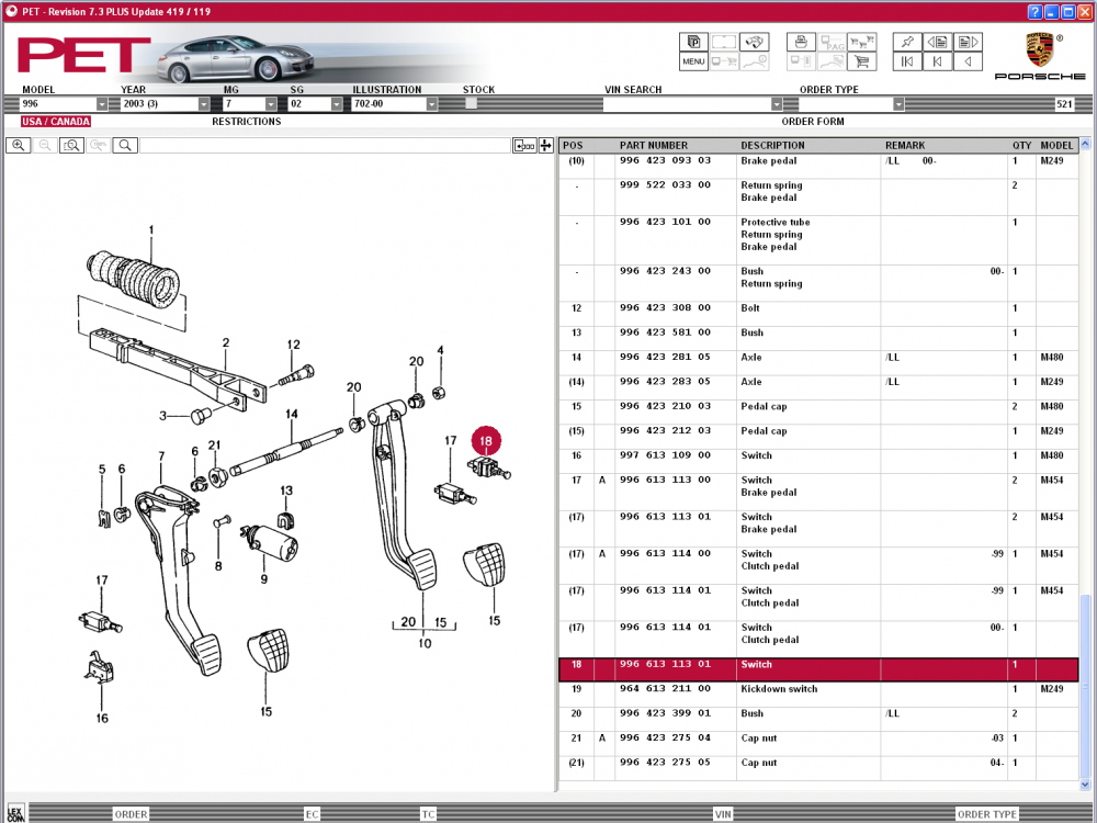

  1. Looks like you are both right. I looked at all the wiring diagrams. MY1999 through MY2001 has two brake light switches. MY2002 - MY2005 has one brake light switch.
  2. Two switches on the brake pedal - one for brake lights and one for cruise control (if you have that option). Two switches on the clutch pedal - one for clutch disengage and one for cruise control (if you have that option).

  7. Are you sure you changed the right switch? If you have cruise control (most US cars do) then you might have changed the cruise control switch instead of the brake light switch.
