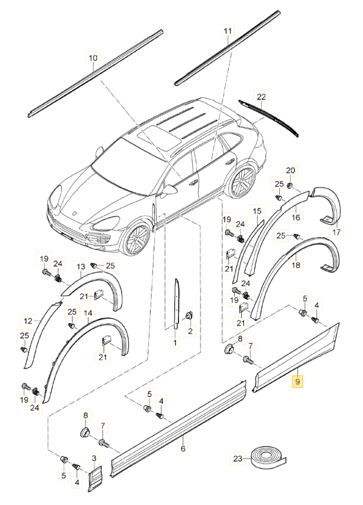

  11. Sorry, I am not seeing a clip on theat parts diagram.

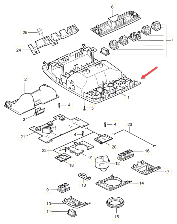

  13. I didn't find anything in the service manual. Here is an exploded diagram that may help. My guess is that you will need to remove the rear hatch door liner to bolt it in place.

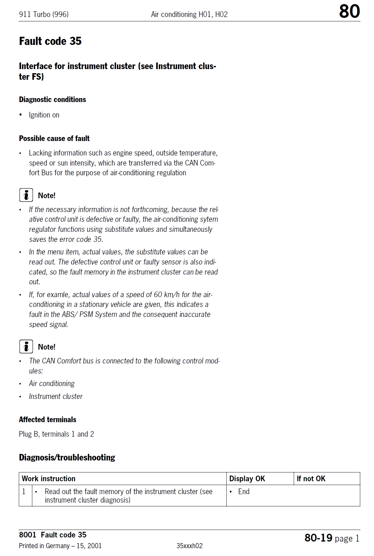

  16. There should be fault code(s) for PSM failure. If iCarsoft does not report that then you will need DUrametric or PIWIS to get the faults reported.
  17. Try 4569
  18. For sure with a Porsche PIWIS tester - perhaps with Durametric, and other scanners may be hit or miss.
