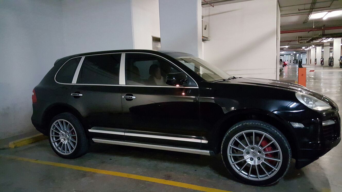

  16. Here she is. With 2008 face-lift looking rather modern.
