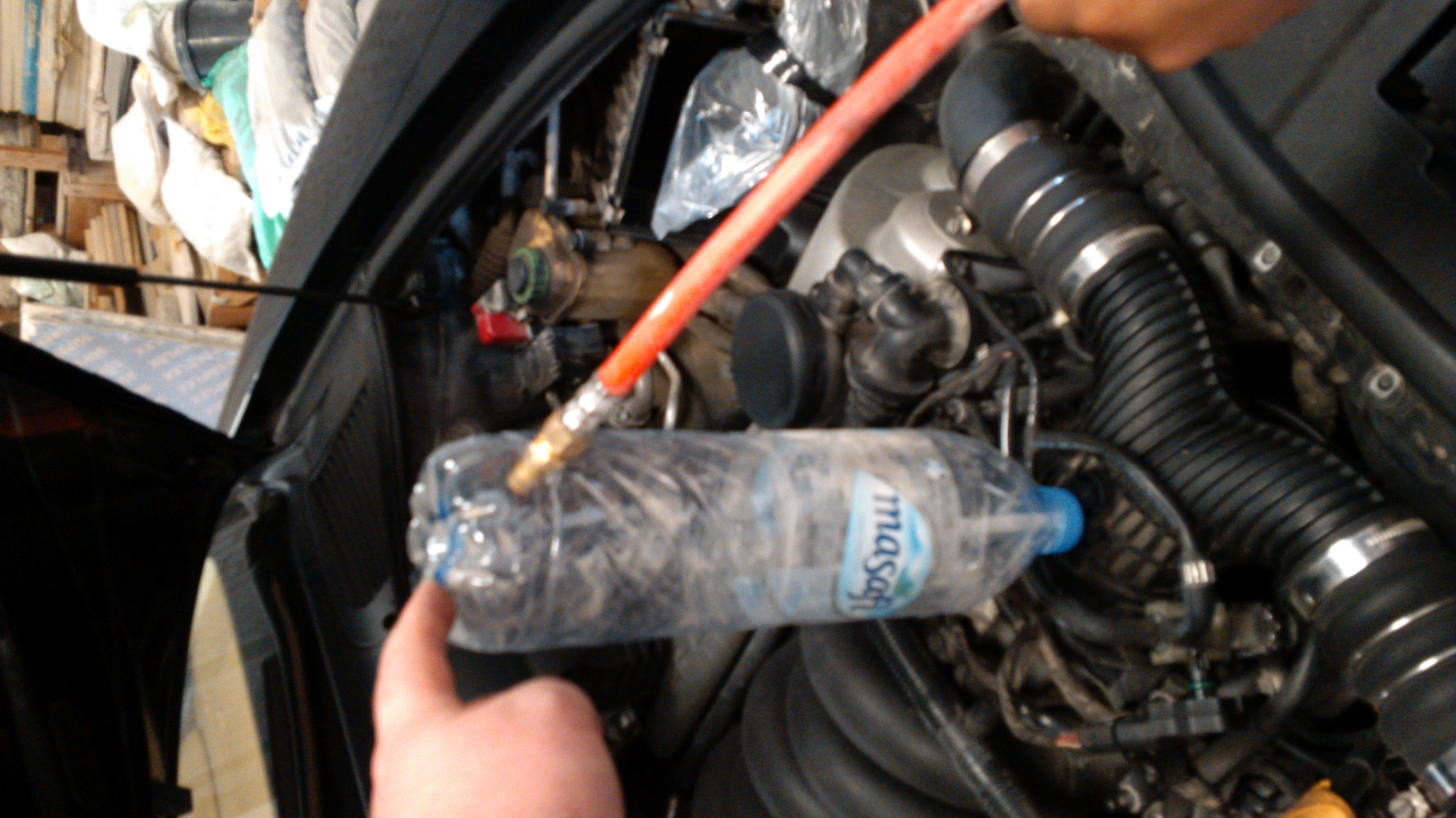

  9. Home made smoker can be made from a clear 2 litre bottle, drill the cap a hole slightly smaller than a cigarette butt, also make a hole in the side of the bottle to fit an air source hose/ gun/ pipe from a air compressor or hand pump etc. Before testing Remove the air box pipes both sides and cover with a plastic food bag and duct tape tightly to make pipe ends leak tight. Remove the intake Y pipe mounted Map sensor, (pictured above my thumb in the second image) one torx screw T25 I think or a flat blade will do it, using the Map sensor hole place the bottle with a lit cigarette in the cap, put bottle upside down on the map sensor empty hole in the intake. Pressurised the bottle with air to force the cigarette to burn and push the smoke into the intake Y pipe and around the system. Look for smoke escaping around left and right side piping from turbo to intercooler and all those pesky vac tubes and other small pipes. You may need to used more than 1 cigarette to fill with smoke, I used 3 Total to get smoke everywhere it wanted to go, didn't find a leak though.

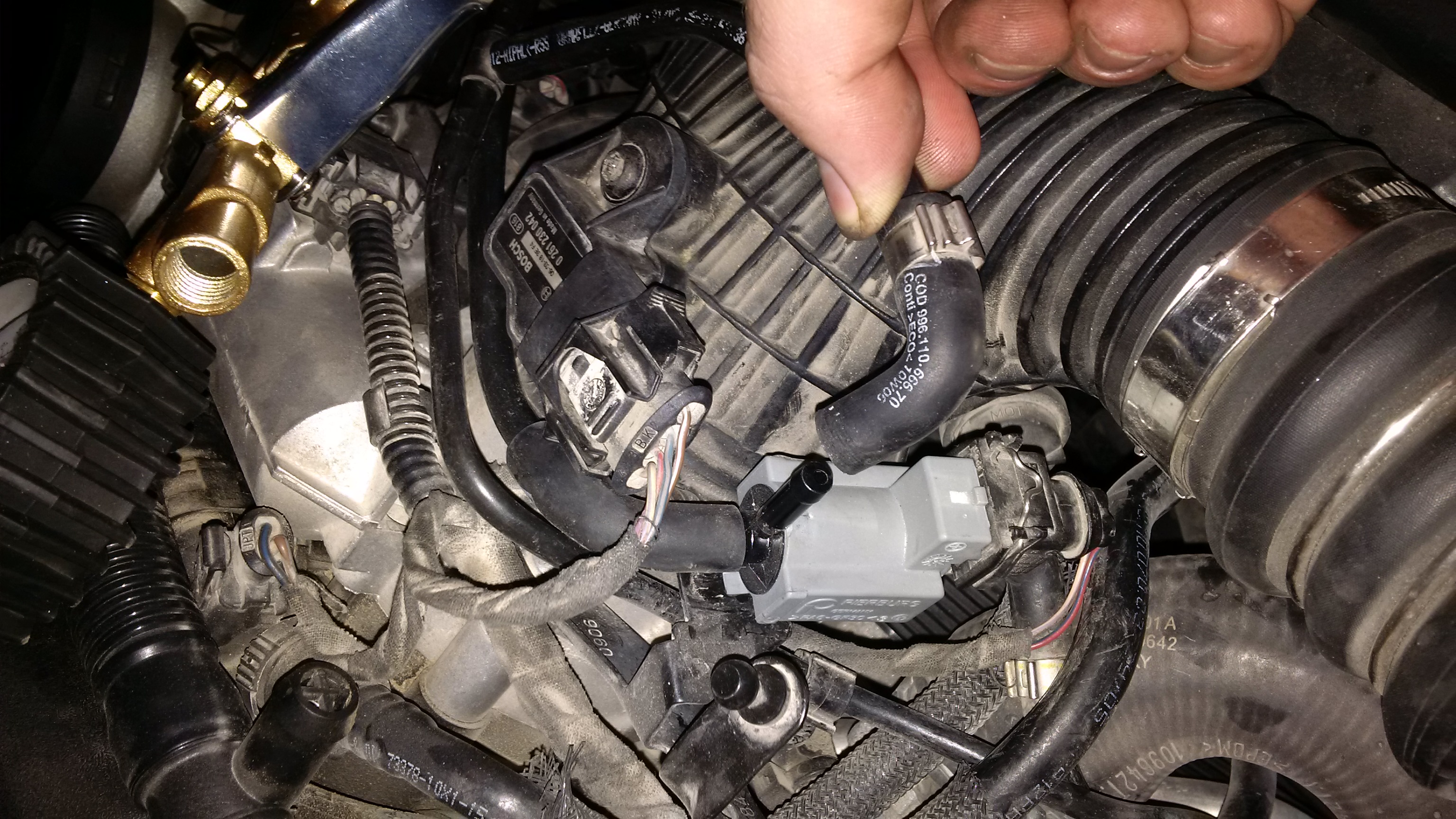

  15. Update for this I have just replaced two check valves found to be leaking numbers 13 and 25 on the diagram. Cleared the dtc codes (no actual codes but this clears the fuel trim learnt values) went for a quick drive 15km and it was definitely adapting to something. Not conclusive yet if this crack the problem so jury is still out, will put on some more km tomorrow and see what's up.

  19. What codes have you got? I did the actuator solenoid Seals today went really well and about 15mins work. I ended buying from local Porsche centre as I couldn't find anything generic in the market. $50 for the pair. See pictures I put rtv gasket seal maker around the lip and used a 32mm socket to gently tap it into place, it actually goes in real easy. Quick wipe around and all done. I also changed the number 13 on parts diagram check valve that plugs into the AOS and two other tubes. One more tube with built in check valve number 25 is on order still. Really excited to get this last part and fingers crossed drive the ctt in top working order as Porsche intended, God knows I put enough time, did so much investigation and spent too much money on this thing now. The wife is questioning my logic in selling the stage 2 tuned 350bhp 2012 Golf R for this bigger boot Cayenne and so am I. Must keep the faith........must keep the faith.......
