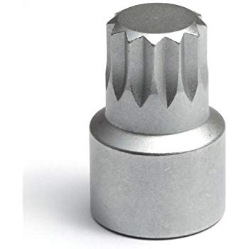

  1. As i remember was a triple square 12. its not a torx. different tool kit.

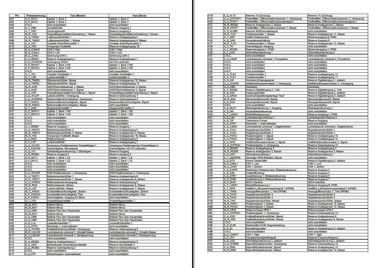

  2. Yep, i can see pin 5 from steering colum goes to pin 18 as speed sensor! I heard about this but needed a confirmation, thanks a lot man! Another problem was solved thanks to this forum! All the best 🙂

  5. Hey guys, i am searchin at many places but i cant find so maybe someone has done the same before. Thanks to one post here i saw we can do retrofit cruise control, however at the tutorial there is 955 with different connectors for the dme, so installed the parts and put the wire ready now i dont know to which pin should i connect it. here is an image of my dme. All the pinout that i see, are talking only for the colorful pins and non of them have the full diagram, i search as touareg as well but still no luck. If you could helm i will apprichiate it a lot, anyways i apprichiate this group as it helped me many times 😛 957 3.6 here.
