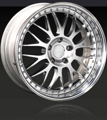

  4. 17" after market wheels are really hard to come by. Autoart VYC is about the only 17"s, I know of,,,high quality expensive wheels.
