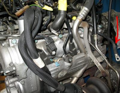

  1. In fact John, it is secure to the body with a bolt (need to be removed when removing the engine) and the other end, I am not sure and cannot see it on all the pictures I took...I have found one picture of the ground when my engine was out. Hope this help.
  2. Also, there is an important ground on the right side of the engine just over the right hand turbo. You should take a look at the condition. Of course, while under the car, take a look at the starter connection as well....

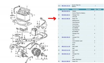

  4. Loren got a good point unless you know that you have created a short by mishandling a live wire....I was trying to found a part number for the fuse and only found a kit for over $28.00. Item 13...May be there is a number on the fuse and you can get it from the dealer....
  5. Current distributor location in the repair manual page 1773 + removing and installing fuses in the current distributor page 1778.

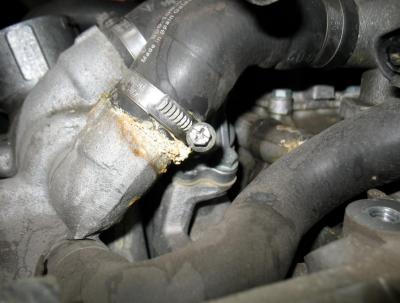

  12. I did not had a chance to work on too many TT's but did a lot of work on mine including engine removal and coolant pipes welding. For a long time I had coolant smell and did not see any drop on the floor but a very small quantity was lost... I also did a pressure check and it was almost completely tight but a very small lost of pressure ( 1 pound for 20 minutes) that I attribute to the tool I was using. One day, before storage for winter, decided to do a very deep inspection and found a very small leak (white powder, dry coolant) after removing the air box and the intake. It was one of the coolant pipes on the water pump housing. Very hard to see, because of limited space and the pipe did not pop out because also of limited space.... And the fluid was trapped on top of the engine and eventually evaporate. Believe it or not even after all this work I still got, sometimes, coolant smell. I feel paranoid about it the first time and did some other inspections but did not found anything. I guess we can consider this being normal on TT's. I also replace the expansion tank cap with the latest model, was 99610644701 and now 99610644704 but the smell is still there....
