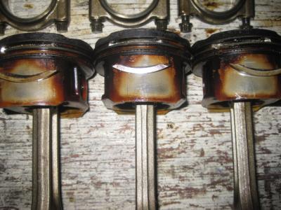

  12. Wasn't my car -- It was a customer's car -- don't know what they had it boosted to. All the turbo equipment was removed -- when they drove it to our shop. Here are some pictures. Block was many mm out of ovality as well. Had to bore it out, replate with Nickel Silicon Carbide and hone back to factory spec. After we get past the break in period of the rings -- we'll give it a dyno test. Mike

  15. We just finished a rebuild of a customer who had a turbo in his 2.5L Boxster over boosted it and broke the ring landings on the pistons. Bore of engine wasn't even close to being in spec -- but no idea if that had anything to do with the turbo charging -- although I expect it did. I highly recommend an intercooler. Mike
