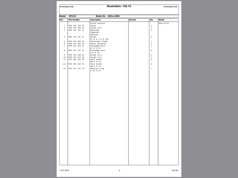

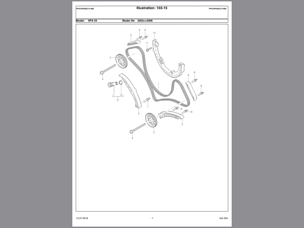

  9. Yes, there is only one hydraulic chain tensioner for your Cayenne S 4.5. It is item 6 on the attached parts list.

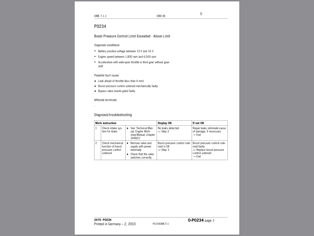

  11. Control lines down to the wastegate actuators do crack / split preventing these actuators from opening resulting in overboost condition. N75 valve and boost sensor on the top of the manifold are also in the loop and are possible suspects. Below post is the troubleshooting guide for P0234.
