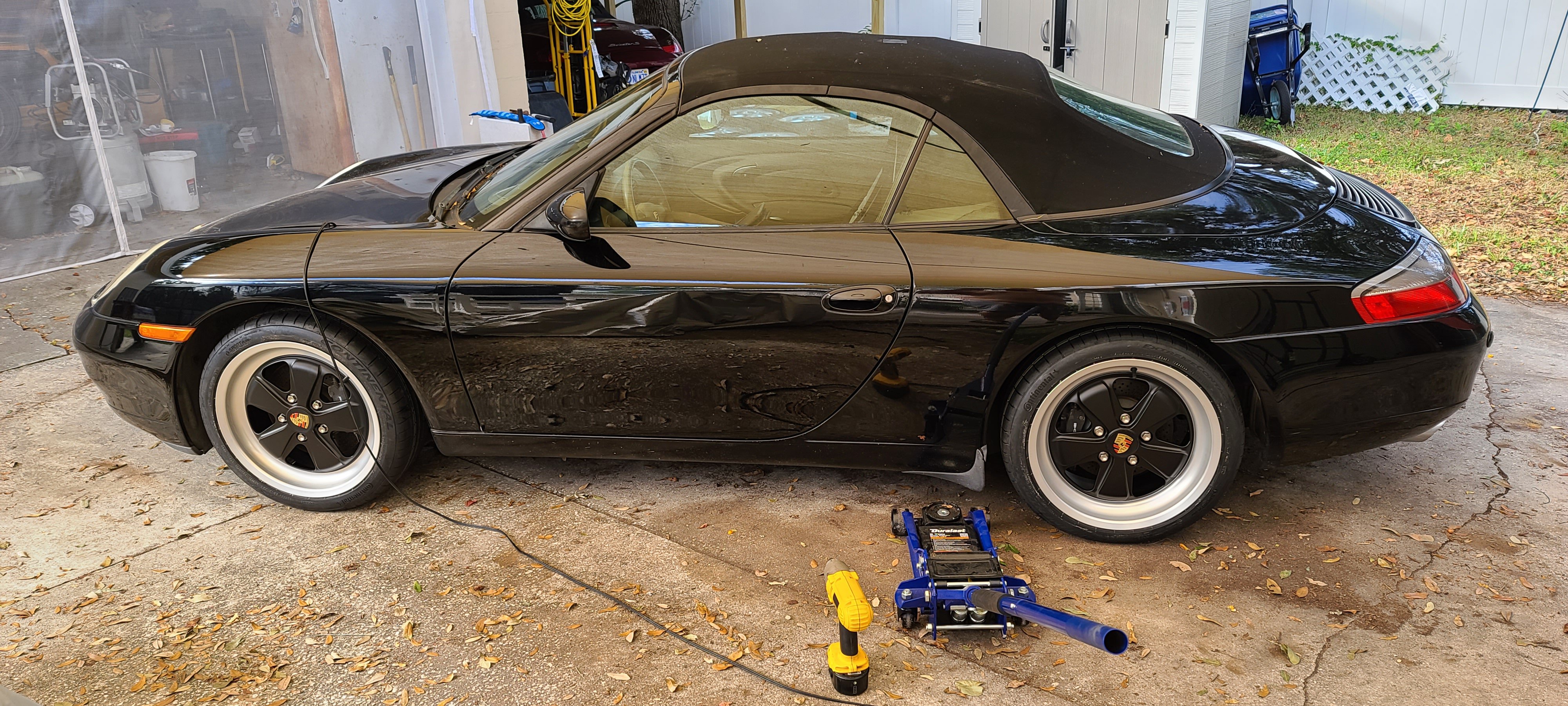

  10. I bought a 996 c2 convertible with ~100K miles on it pretty cheap a few months ago. Top/windows were a hot mess, thus the price. I kept it in the garage and fixed all of that. It has reverse parking sensors and PCM-1. I would like to add bluetooth to it and leave it stock. Temporarily I have a bluetooth cassette adapter that sounds tinny. I ended up getting frustrated with my boxster and did the GT3 delete, new marine head unit, and new speakers. I like the authenticity of the PCM (who had gps back in 1999?) and it displays a lot of computer data like gas mileage. Also the delete piece only comes in black, red, or tan now, and the interior is grey. And replacing the dash speakers sucks. Any opinion on which way to go? Or suggestions on better bluetooth solutions? I had the rennkit thing, and that's crap.

  13. Resurrecting this thread since it was the only I saw about the fuchs. I am fixing up a 99 black 996 cab. It has the typical 18 inch turbo twist silver wheels. I was looking at the fuchs 18s with the black center and silver lip. They're on sale at suncoast for $4300. However rosepassion.com has them for ~$3200 with vat and shipping. Anyone have any experience with fitting these and that second site? I'll wait a bit to save $1100. That'd pretty much cover the cost of new rubber. Families of parts for Porsche 996 / 911 Carrera / 1999 / 996 carrera 2 / Cabrio / Manual gearbox, 6 speed WWW.ROSEPASSION.COM Porsche 996 / 911 Carrera 1999 996 carrera 2 Cabrio Manual gearbox, 6 speed https://www.suncoastparts.com/product/pk996fuchs.html

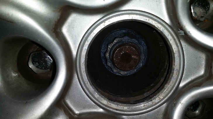

  17. I used a short breaker bar with a floor jack under the end to get the nut loose. I believe it's 380ft-lbs but not positive. A 2-3 foot long wrench means ~200lbs of force so either reverse the floor jack plan, or stand on it. I probably won't even bother if I don't have a torque wrench with that range handy, just make it REAL tight with my breaker bar. I bought to the socket at Northern Tool. You may want to get a deep well so you don't need an extension to reach it.

  19. I'm not seeing any DIY on replacing the front CV joints and or stub axles. I assume this is because it is really easy... I'll take pictures just in case. Tools needed: 32mm 12 pt socket. (not 36mm as some online guides suggest)
