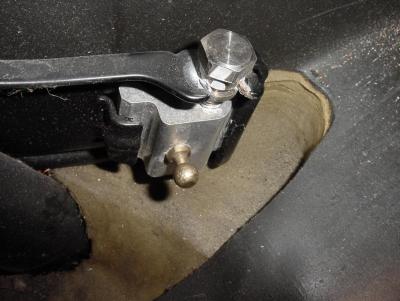

John: Here you go (click on the photos to enlarge): Here you have, from left to right, the pushrod (with plastic ball cup), the rubber bush (oriented in the correct position before insertion into the tail of the pushrod), the guide sleeve, and the Allen head countersunk screw temporarily located in the forward arm of the V-lever. Here is what they look like after assembly. Regards, Maurice. -
