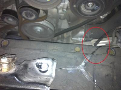

  8. This is the exhaust vacuum for my sport exhaust <insert raspy growl here> ... Not really sure if it's something to be concerned with since it's presumably been broken for some time (didn't notice until I pulled the MAF off to get into the engine to do some other work) and my car seemed to fun just fine -- either way, I am going to replace the tube.... If it's there I assume the Germans put it there for a reason.

  13. Anyone know what the broken plastic tube is that I have circled in red in the attached pic? I pulled the MAF out to work on my alternator and noticed this directly under it as you can see with the engine in the background. Is this something I should be concerned with?
