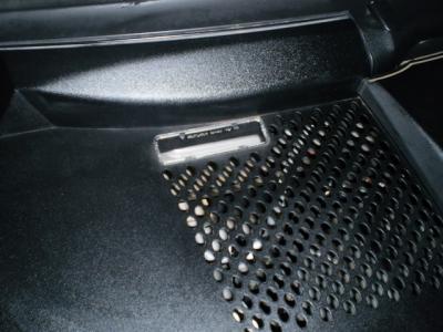

  15. There is an updated grommet for the early 996. I don't remember which years this applies to, but if you look at the picture you can tell if you have the latest. There is also a clear plastic cowl plug that keeps leaves and other debris from entering via the VIN ID cutout. Both improve the dreaded water back up problems.

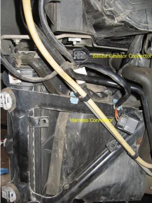

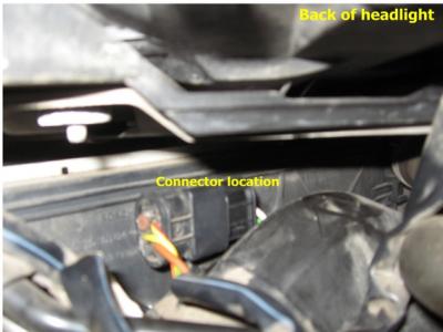

  16. I just replaced the fan resistor on my 996 as well. I have added a couple of pics to go with Perry's post.
