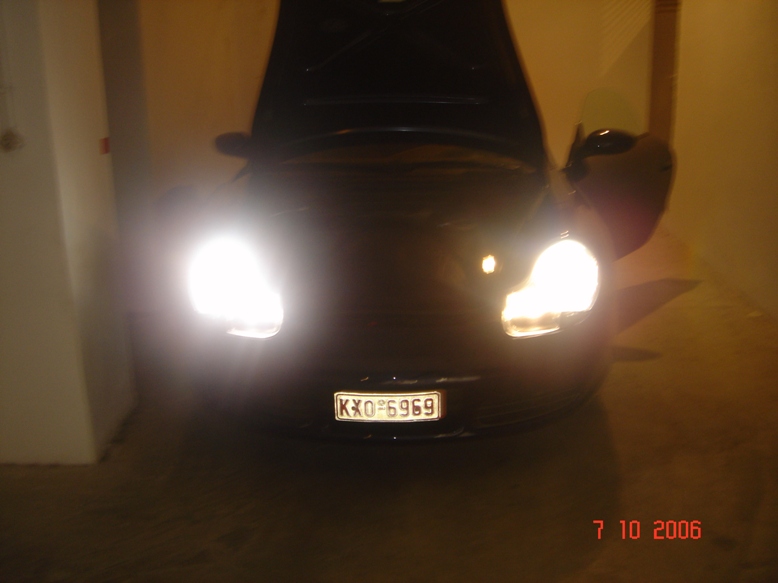

I finally changed both the high beams and the fog lights with PIAA H7 in Extreme White 4700K. I have attached a picture of the Boxster with the PIAA bulbs on. The left hand side of the car the fog lights are the stock ones and on the right hand side of the car (passenger's side) the fog lights have been changed to PIAA. You can tell the difference (although not so clear in the picture) where the new fog lights are not yellowish.
Thanks all for the help.
