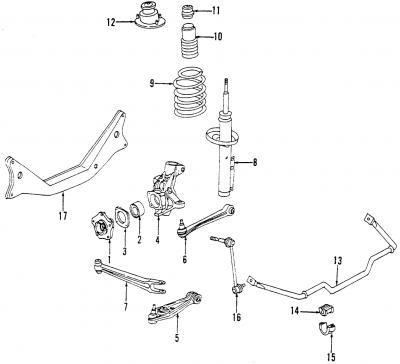

don't know if there's a write-up on it, but it's easy. for descriptive purposes, the lower control arms are the ones that the wheel carriers are attached to (part #5 in the pic below). the upper control arms (a.k.a. track rods) that you want to replace are part #7 in the pic below (FYI, the part number is 986.331.043.07 and they're the same on both sides of the car.
jack up the rear of the car & put on jack stands (chock front wheels).
remove the rear wheels.
remove the bolt that attaches the upper control arm to the lower control arm (bolt head is 18mm, nut is 21mm).
remove the bolt that attaches the upper control arm to the chassis. i think the bolt head is 18mm. the nut is designed to stay on the car, but you still have to hold it. it's not a typical nut, it's square. hold it with an 18mm open ended wrench.
slide arm out of car.
install in reverse order. torque for both bolts is 160NM / 118lb-ft.

OMG, that is easy!, thanks insite, ill tke a rubber malet to my suspension to isolate the noise and i hope it is the rear control arm instead of the Rear Strut...the more i drive the car, the more i think the struts are fine cause they arent spongy at all, they are pretty firm and i dont float around at all...Im pretty well planted to the ground at any speed.
