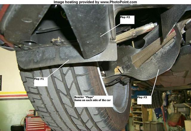

any chance I could get flap #2 numbers for both sides, plus the screws and clips for it and #1?
and a question about flap #2, it wraps around the entire hole in the front and looks kinda like a V doesn't it? mine were torn off by a speedbump so I can't tell for sure if it's 1 part or 2

Cassiebox, do you have any idea what the part no. is for them?? Thx, Jon
try Sunset Porsche in OR or Suncoast in FL. They usually have the best prices.
Here you go for the 986 (I might have the sides mixed up but don't think so):
Driver side: 986.504.393.0001c
Pass side: 986.504.394.0001c

I've also found that if the back flaps are mashed, the front ones (in front of wheels) probably are too. So, you might want think about what other parts/upgrades/maint you can order at the same time to save on frt ($7-10 flat fee based on zip). For instance, do you have the (OEM) Euro cig lighter which allows US plugs to fall out? For $13 you can change it out. How about filters (cabin & engine) and serp belt? Plugs? Is your AOS starting to go bad?
Good luck :)
