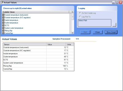

As Loren had pointed out Durametric upgraded their software recently which gave me the ability to see real time values for the automatic AC system. (their software rocks and is well worth the money http://www.durametric.com/)
I have had lack of heat (warm at best) from the system and that is ONLY when I turn the auto/AC (snowflake) off. Additionally I run at 180-190F so I ruled out thermostat, plus the coolant level is correct.

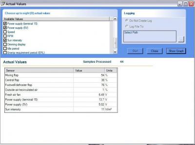

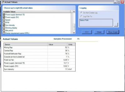

So as was proposed it could be the air mix flap, a failure trend. The Duremtric software shows the full range of motion I would expect for the Mix Flap. 99% for on HI and 1% on LOW an a constant mix in the middle when that temp is selected. Additionally the footwell/defrost flap and central air flap all appear to be working correcty. As far as I can tell the entire automated system is working correctly. No error codes

Examples of Durametric output attached:

I do have a thermal sensor gun that I will check in detail tomorrow to compare to the actuals as you state. Since I don't think quick "on the fly" with celcius I really didn't digest all the temperature values while outside. Since I'm now inside and converted them to fahrenheit I do see a couple of odd (to me), things:
1. Inside Temp 31C (87.8F) with windows rolled down in 50F outside temp while ACC was at 82-84F
2. Outlet Temp 49C (120.2F) also seems high, but I don' t know where the outlet sensor is to consider its reading. A thermal will NOT get a similar reading at the vent.
When the ACC is set by me to 84F the mix flap is at 99% as expected yet the INSIDE TEMP claims 87.8F which should move the mix flap somewhere between 1-75% to start lowering the temp. I do note if I set the ACC to 74F then yes the mix does go to 20-30%.

OK, I couldn't stand the wait so I went back out and got the car warmed up. I waited for the fan to kick in and then took some "real readings" and compared them to Durametrics ACTUAL VALUES.
At this time it appears I have heat. Either:
1. The software reset something and now the mix flap works (doubt that's it)
2. The thermostat is stuck open and I an only get heat while at idle. Motion causes the stuck open thermostat to keep the coolant temp to low while in motion as the radiator does its job to the open system. Tomorrow I'm going to take the laptop on the road and drive to work. I'll pull over quickly 1/2 way and check the ECTS temp to see how cool I really am (or not) at 60mph speeds.
Why do I think it may be the thermostat even knowing the dash gauge temp seems ok?
at 195.8F ECTS (coolant temp) I show the following computer values:
95F inside temp
125.6F outlet temp
while my thermal gun shows temps up to 138.5F inside the center vent, 128F at the drivers side vent and a old school chef's thermometer stuck in the vent shows 110F. I would guess those temps are acceptable enough to see the heat is working (at the moment).
