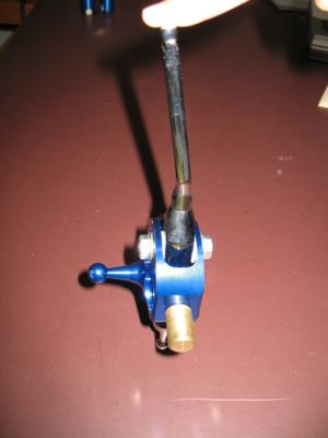

Machster simply removed the nut and bolt, removed the lever from the blue housing, rotated the lever 180 degrees, and put it back together so that the bend is to the right where is should be. A simple fix for a screw up at the factory.
I have not seen the ebay clone in person. But it looks identical to the B&M unit (except for the lever issue). For $55 I do not know how you can go wrong. It has 2 set screws, while B&M has 1, so use just 1.

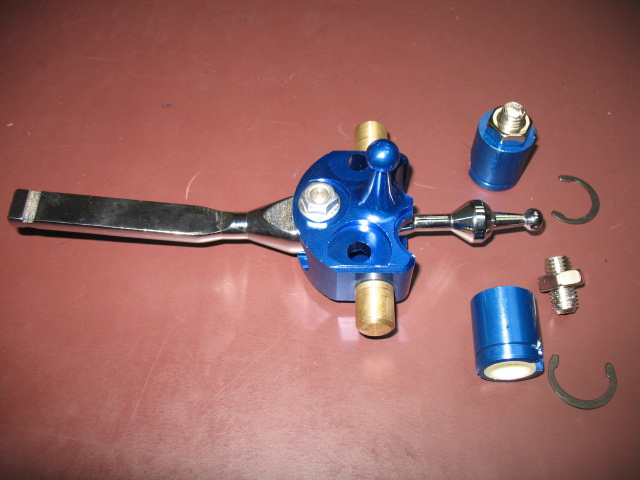

There are other people on Ebay selling the clone. Here are slightly better pictures which shows that the shift lever is 180 degrees reversed in the blue housing. You can see that the lever is bent towards you, when the bend should face the other way.

The shift lever is in fact 180 degrees reversed in the blue housing. It is the first thing you notice when you pull it out of the box, after having seen and installed a number of B&Ms.
I do not like the fit of one of the plastic inserts.
I am trying to borrow an uninstalled B&M still in the box so that I can put them side-by-side for a comparison.
I just looked at several clones on ebay from different sellers, and with one exception the lever is backwards.
On the ebay pic clone below the bend of the lever is correct, to the right. The rest of the ebay pictures from the other sellers were backwards.

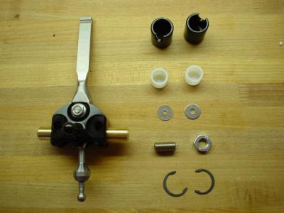

Blue2000s.
On the 986forum you said the the teflon bushing (that you had made) is on the right, the stock on the left. Did you reverse them in you post?
The reason I ask is that the bushings on my clone looks just like the bushing on the right in your picture - down to the machining marks inside the bushing at the bottom of the bushing. Also, the color of the material of my clone bushings is the same as the bushing on the right in your picture. My bushings are sort of yellow, not bright white.
Blue2000s.
I must be a closet dyslexic, sorry. The Teflon part is the white one, the nylon is yellow.
That is ok. I thought they were reversed due to the color and machining marks.

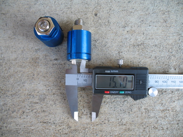

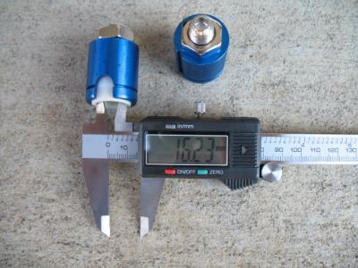

Right now, I have a problem with doing a comparison. The diameter of the 2 cup bushings are not the same on the ebay special....
TP-
Can you confirm the measurements are 15.7 and 16.2 (appears to be a reflection on one)? Did you measure the pivot arms of the shifter too? Curious to those #s. If not, do you think the .5mm difference will affect function all that much? The variance between them is just under 3.2% so I suspect not, but then again I have no idea what the tolerance should be on this item. Did anyone measure the shifter bushing on the stock shifter they took out?
I'm curious b/c I too bought this shifter from ebay. I haven't installed it yet, but mine seems pretty tight. Let me know your thoughts.
The grooves in the machined plastic in the ebay part are indicative of a either a very poor machine or a ver poor machinist or both. A 0.5 mm difference between just 2 parts is a really bad sign. A variation of a machined part like this should be +/- 0.1 mm at the most.

This is a problem. The inside diameter of one of the cup bushings is too large. The other bushing is ok, a snug fit like it should be. Strange that they are not both machined the same. If I was to put the shift in a car with that bushing the way it is the lever would rock.
