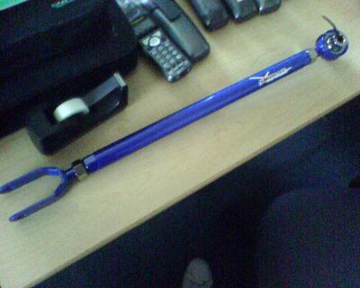

P.S. I have attached an image of the Rear Control Arms.

this is a known problem. the control arm ends each have a bearing in them; the bearing rides on nylon bushings. the grease runs dry, the nylon wears, and the bearing gets loose. you will notice the sound a LOT more when it's cold out. it IS possible to press out the race / bearing assembly, but i've yet to find a replacement unit. i'm also working on fitting zerk type fittings to these so that i can add grease and hopefully get rid of the clunk without buying new arms. i wish porsche made their suspension parts servicable.....
