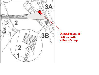

Incidentally, i managed to get hold of a pic of the exact strap and fabric i'm referring to: -
So you can see that the strap on the left connects to the upper frame while the fabric to the right pulls on the outer hood. The whole thing keeps the side nice and taut. The problem is with the fabric (3A) creeping upwards onto a protruding section of the brace (visible in the pic) and just above the widest section of the fabric.
I suppose that you can directly tell from the pic that loosening the strap by dropping down a screw-hole may fix this in 5 mins but i don't know how this will affect the appearance of the hood from the outside. You may have trouble retracting/opening the hood around the window area or buffeting issues at speed.
Pop
I had this same issue and simply stuck a round piece of felt to both sides of the strap in the location shown in red. It seemed to do the trick and my noise was really bad.

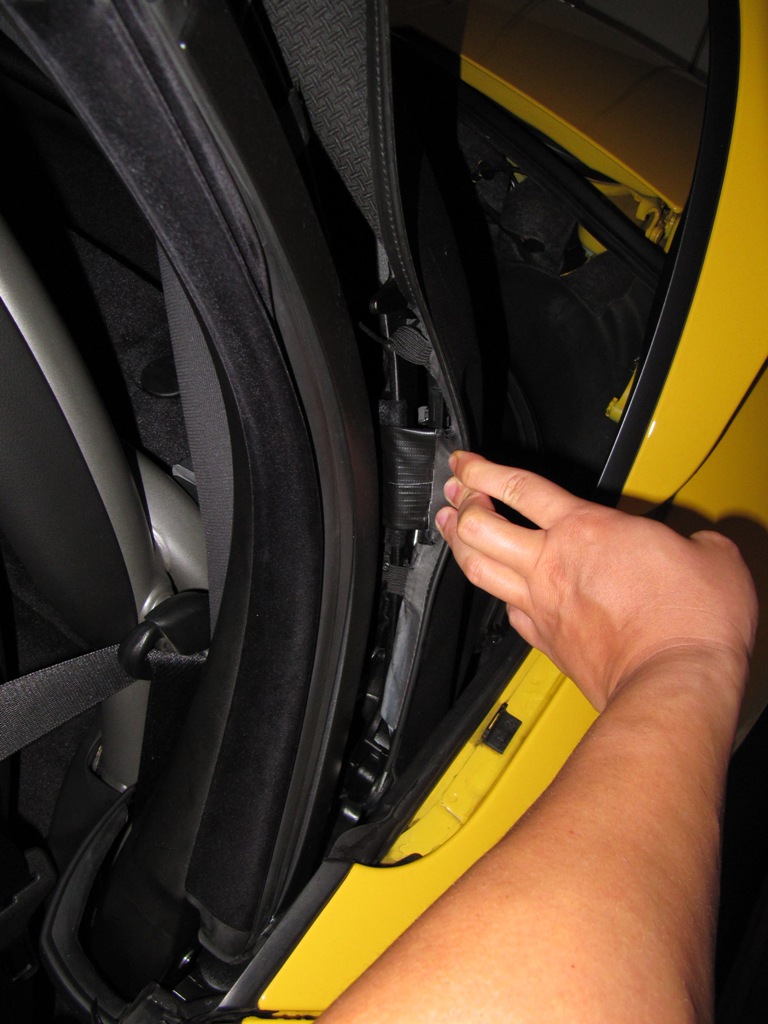

Ok. Lube and felt didn't work for me. Today I covered up that triangular fabric piece with duct tape and the silence was unbelievable. Even drove with the top up in good weather with the radio off to enjoy the silence.
Thanks for the help!
Edited by beeferino
Share this post
Ok. Lube and felt didn't work for me. Today I covered up that triangular fabric piece with duct tape and the silence was unbelievable. Even drove with the top down in good weather with the radio off to enjoy the silence.
Hello, thank you very much for all the great information!
Beeferino, can we trouble you to post pics and instructions on how to make this fix?
Share this post
Hi Surge74,
I just simply followed the diagrams supplied by Popolou and dschulenberg. Instead of putting lubricant or a felt pad sticker (my car came fitted with a felt sticker on the part of the roof frame touching the rubbery fabric piece), I wrapped duct tape round the rubbery fabric piece. it's a little tricky maneuvering the duct tape in there with 1 side sticky, and without taking apart the whole fabric roof. Maybe you can try sticking the tape on some wax paper first, getting it in, then pulling the paper out when you are ready for final application.
I've attached some pictures where I'm pointing to the offending fabric piece and the duct tape can be seen. In the second picture, I'm pulling the roof off the B pillar slightly so more of the fix is exposed.
Hope you solve the problem. It almost drove me mad trying to figure out what it is and rectifying it.
