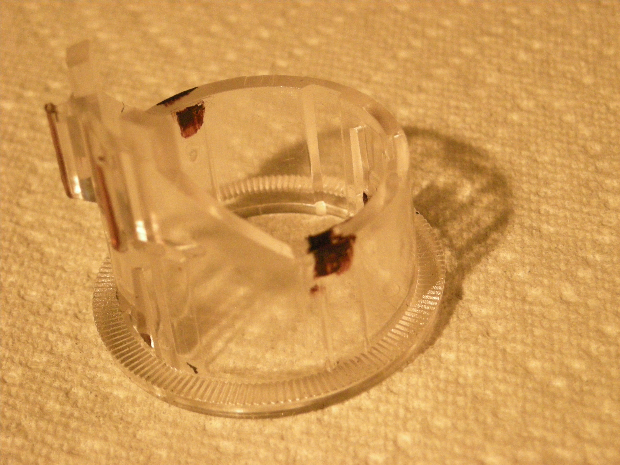

Notes from my experience removing my lighter assembly (2000 Boxster, same process for the newer, longer lighters from 2003? and newer.)
- Pry off the dash trim piece with your fingers, pulling from the bottom. I did not remove any of the wire harnesses from the switches above the lighter.
- The lamp assembly is on the top side of the lighter. Remove the black retainer clip (closest to the wire harness) by spreading the sides outward and simultaneously popping the retainer upward, all with a small flat screwdriver. It should not take too much force after the sides are spread.
- Lever the rear (closest to the wire harness) of the green lamp assembly up with a medium screwdriver. (The copper tabs are simply spring loaded against the ring.) I thought I was going to break the lamp holder but it popped off intact. Mine needed an uncomfortable amount of force but it is actually pretty robust.
- The metal tube must be pushed through the dash trim, toward the rear of the car, before the plastic ring can be removed. There is a small plastic square protrusion, approx 2mm x 2mm, molded into either SIDE of the inside surface of the plastic, which engage 2 small square holes on either side of the steel tube.
(I colored the tabs black in the mediocre photo.)
You can try to spread the 2 tabs away from each other, working from inside the steel tube, but this did not work for me. You can try to squeeze the sides of the steel tube away from the plastic tube with channel lock pliers. I was unable to twist the steel away from the plastic. What finally worked for me a sharp blow with my palm, from the wire harness end toward the front of the lighter. The metal tube popped out.
- After the metal tube is removed you can easily insert a small screwdriver, from the front (seat side), to depress each of 2 plastic tabs on the top and bottom of the plastic trim ring.
This procedure is crazy difficult compared to your expectations. Take your time, relax, and step away for a few minutes if you are tempted to use too much force.
