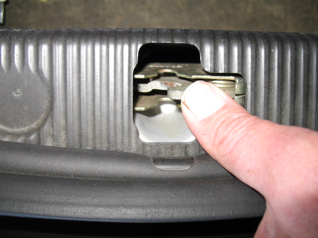

Open your rear trunk with the door sill lever. The rear trunk light should be on. Then push the latch down with your finger and close the latch. If you cannot push hard enough with your finger then use a screwdriver. When the latch is closed the trunk light will go out.
Then push on your button and watch the latch to see if it unlocks - if not try the other remote. Listen for any noise. If it still does not unlock with the remote then use the door sill lever to lever to unlock it.

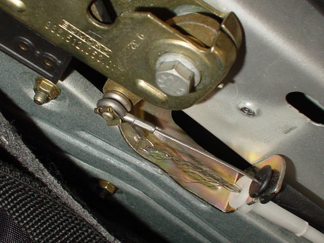

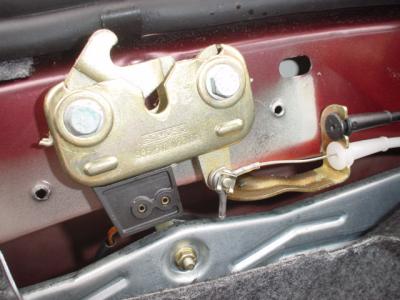

There is a black plastic cover for the latch with 2 screws. Remove the cover and see if the cable for the remote is broken. I think on your year there is a black on top and below that white. You may have to pull back the carpet to see what is going on.
In the first pic the black cable is broken. I think the black is for the lever. In the second pic the white is broken. I think the white is for the remote. Or maybe I'm confused because there is also the emergency release cable.
When you push the remote button a solenoid pulls on the cable and opens the latch. I think Porsche calls it an actuator. If the cable for the solenoid is broken then that is why your remote does not work. If it is not broken then I would guess a bad soleniod, more so since you do not hear it trying to work. Or, there is something wrong with the control unit under the seat. Also check the fuse.

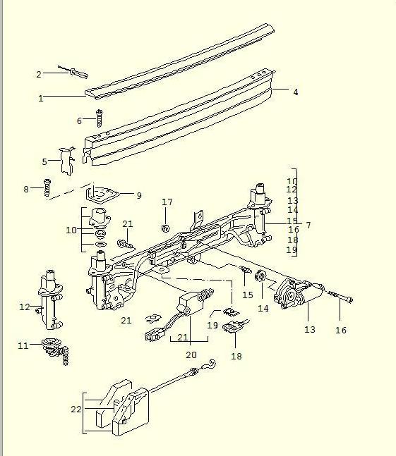

If this helps the parts diagram has your model year actuator as #20. #22 is that part for a newer car. #13 is the motor for the spoiler.

I pulled the rear spoiler and the rear trunk area so I could get in there and investigate this some more. I was able to locate this 'trunk actuator' and it actually resembles #22 in the picture above. The part number on the casing is 996.624.117.01. Does that align with your part diagram?
So I looked through the electrical wiring diagrams in my Bentley manual, and the plug going into this actuator has a red wire and black wire with a blue stripe on it. Per the manual, the red wire has +12V on it. I checked it and indeed it does. The black/blue wire comes straight from the alarm control unit and I was unable to tell what the voltage should be. It was reading about .3 to .4 volts. So, I did a test, and after holding the trunk buttond down for 2-3 seconds, the voltmeter spiked. However, I was unable to tell what it spiked to because I have a digital voltmeter and not an analog one. If I knew it was supposed to spike to +12V, I would test it outside of the car.
However, based on these results, it seems to me that the remote and computer is working properly and the computer is sending the voltage signal to the actuator at the right time. I assume the actuator must be bad.
When doing a search on this part number I listed above, it didn't mention trunk actuator. Pelican Parts calls it a 'Setting Element'. A similar part number but with 00 at the end instead of 01 is called 'Release Actuator'. So do I need to buy both of these parts? Tool Pants - do they list more than one part number for item #22 in that part diagram you have?

PET has the actuator for 1997-2000 as 996 624 117 00 and it is shown as #20 on the parts diagram. 2001 up is 986 512 117 00 and is shown as #22 on the diagram. But as you say, yours looks like #22. So the diagram is wrong (and it would not be the first time PET has been wrong) or you got a weird car.
Let us know what it turns out to be. Funny that it apparently has never worked, but then I could not see what it would have to do with the fact you have an Aerokit.
