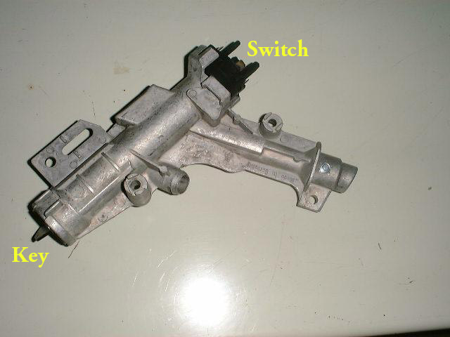

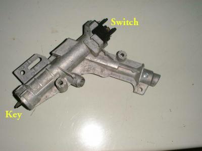

In Loren's link is a picture of a switch I took apart. A piece of plastic inside the switch had broken off. That can't be due to the weight of a key chain. It is just a crappy switch. And this was the 4th generation switch used by Porsche until Porsche went to a different design.
The mechanics gave me another defectve switch for an autopsy so I can see if it has the same problem.
