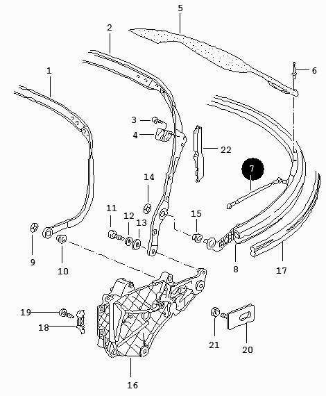

I believe this is the part you are looking for (one for the right side, one for the left side):
post-6627-0-95621000-1298568453_thumb.jp
It's item # 7 in the diagram...Porsche part number 996.561.931.01
Double check with your parts supplier before ordering to make sure.
Regards, Maurice.
Thanks for the reply,I will check, but those appear to be short.
As mpikounis wrote, the cable seems to run inside a plastic channel which is part of the convertible top canvas, from corner to corner on each side (as he shows in his picture).

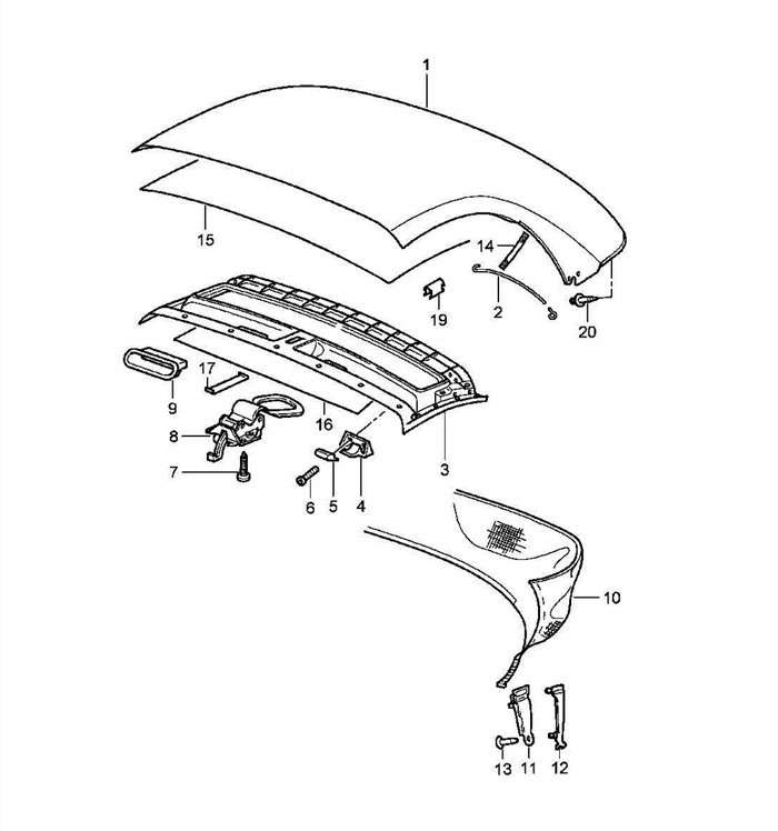

PE:
Although the cable appears to be short, I believe that is only because of the illustration, which is not to scale.
I have replaced the same cable in a Boxster and the illustration is the same (cable is item #2). Although it looks short, the cable (in a Boxster) runs from under the B-Pillar frame of the convertible top, where it terminates in an eyelet, to the aluminum shoulder plates on the sides, near the front of the top, where it is attached to those plates with a spring, as the OP described.
Here is the same diagram from the Boxster:
post-6627-0-70588000-1298572773_thumb.jp
