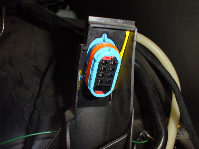

I had a problem several weeks ago seating my passenger right side light. I was very careful pushing it in but had a heck of time. I had advice to twist the wrench to seat it in while pushing at the same time. Apparently the previous owner or ham-fisted service tech had broken the clip that holds the female socket into place. I ended up having to (gulp) use duct tape to hold the socket into place. It looks like it would be expensive and difficult to replace. If problems arise I may have to splice longer wires into the socket and just plug it in before sliding the unit in. I’m not comfortable with it the way it is now because I don’t know how far in the light seated into the socket. I may go ahead and rewire it just to be on the safe side. I’m concerned about a poor connection over heating.
If this is the broken clip you are talking about - then replace it.
is the clip replaceable or do you have to replace the whole mounting assembly? Mine busted a while back, so I removed the wiring harness and snapped off part of the bracket to get it out. It was the only way to get the wiring out far enough to manually attach it to the light. It appeared at the time that this clip is part of an entire molded piece that the headlight assembly sits on.
Please advise. Also, where does one get this, how much, and what's the part number?
Sorry, I wasn't specifici enough, broken parts are the yellow clip and part of the blue socket was chipped and broken away. I wish it was just the clip it wouldn"t be a problem to just repace the clip. A heck of a lot easier than rewiring the socket. You may have the best idea and I'll see if I can get a new socket and just rewire that along with a new clip.

Left clip is 631 245 00. Right 996 631 246 00.
Black plastic bracket that you slide the headlight into and then lock it in place. Left 996 631 041 00. Right 996 631 042 00. According to PET if you buy a bracket it includes the clip.
