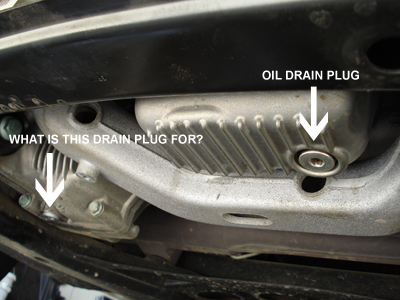

HELP PLEASE...I followed the steps below BUT the only second 8mm plug that I found did not have motor oil! when I removed it, some smelly green hue oil drained from it, I'm sure it is nit motor oil...does anyone know what kind of oil might have been in that receptacle as I will have to replace it...also, where is the second 8mm drain plug? I could not find it anywhere...
Here is a picture of the drain plug I wasn't supposed to have removed.
Thank you

HELPPPP! I did the same as the below - What is the other oil? It did have a green hue with metallic looking pieces and smelled. Does anyone know what that is and how to replace it???
Thank you

I don't know why your oil would be green - has a dealer ever changed it?
Here are the locations (the other drain is just on the other side of that cross member.

Changed oil on 2009 Cayenne T but dint look for the second plug. Later found this post and started wondering, looked at PET pictures but could not find that second plug neither on oil-conducting housing (948 107 071 54) no on oil pan (there is only one on picutre 900 219 020 31). Am i missing something or these pictures not correct (Pet update 235 - latest). DOnt want to go under and take all panels off just to satisfy my curiosity. Anybody knows? BTW thanks to this forum for a tip about ziplock bags and oil filter changes.
